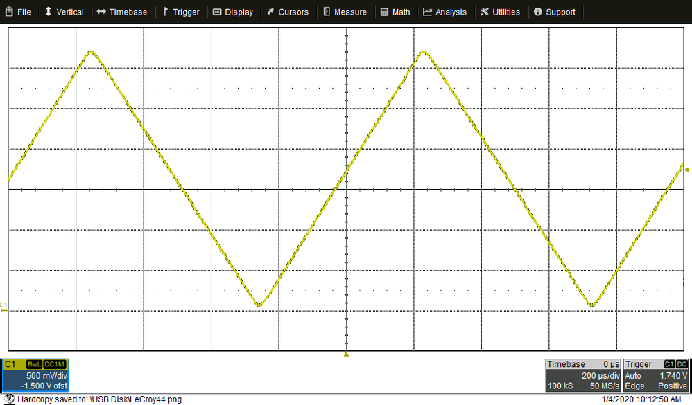

OK, below are the parts of the original appnote code which were somehow modified...
/* USER CODE BEGIN PV */
#define DITHER_TABLE_FIRST_PART     ((uint32_t*) aDitherTable) // 3 bits EXTRA
#define DITHER_TABLE_SECOND_PART    ((uint32_t*)(aDitherTable + 4)) //was +8
//the defines could be removed as we have two different functions to update the aDitherTable[8]
#define TIMER_PERIOD ((uint32_t)16)
uint32_t aDitherTable[8]; //was [16]
uint32_t DitherIndex = 0;
uint32_t DCycleIndex = 0;
uint32_t UpCounting = 1;
//this table gives optimal dithering pattern in contrast to the original function "UpdateDitherTable"
uint32_t ditable[8][8]={{0,0,0,0,0,0,0,0}, //0
{1,0,0,0,0,0,0,0}, //1
{1,0,0,0,1,0,0,0}, //2
{1,0,0,1,0,0,1,0}, //3
{1,0,1,0,1,0,1,0}, //4
{1,1,1,0,1,0,1,0}, //5
{1,1,1,0,1,1,1,0}, //6
{1,1,1,1,1,1,1,0}}; //7

if(UpCounting == 1){
UpdateDitherTableB(DITHER_TABLE_SECOND_PART, DCycleIndex, DitherIndex); //AA
}else{
UpdateDitherTableB(DITHER_TABLE_SECOND_PART, DCycleIndex, DitherIndex); //BB
  UpdateIndex();
 * @brief Period elapsed callback in non blocking mode
 * @param TimHandle : TIM handle
 * @retval None
void HAL_TIM_PeriodElapsedCallback(TIM_HandleTypeDef *TimHandle){
HAL_TIM_PeriodElapsedCallback(&htim1);
 * @brief DMA half conversion complete callback
 * @note  This function is executed when the transfer half complete interrupt
 *     is generated
 * @retval None
void HalfTransferComplete(DMA_HandleTypeDef *DmaHandle){
     UpdateDitherTableA(DITHER_TABLE_FIRST_PART, DCycleIndex, DitherIndex); //CC
    }else{
     UpdateDitherTableA(DITHER_TABLE_FIRST_PART, DCycleIndex, DitherIndex); //DD
  UpdateIndex();

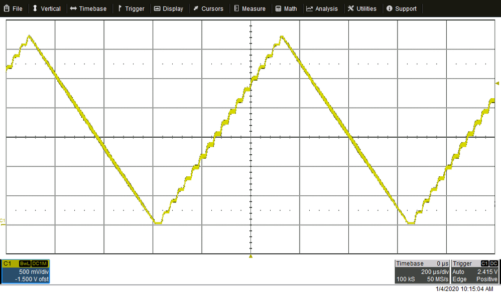

note - I was not sure what is the magic of using ((uint16_t*) aDitherTable when the array was defined as uint32_t aDitherTable[16]... so I used uint32_t...
output when there is "DitherIndex" supplied to the function "UpdateDitherTable" at AA, BB, CC, DD places.

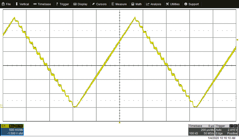

output when "0" placed instead of DitherIndex for AA and CC
output when "0" placed instead of DitherIndex for BB and DD

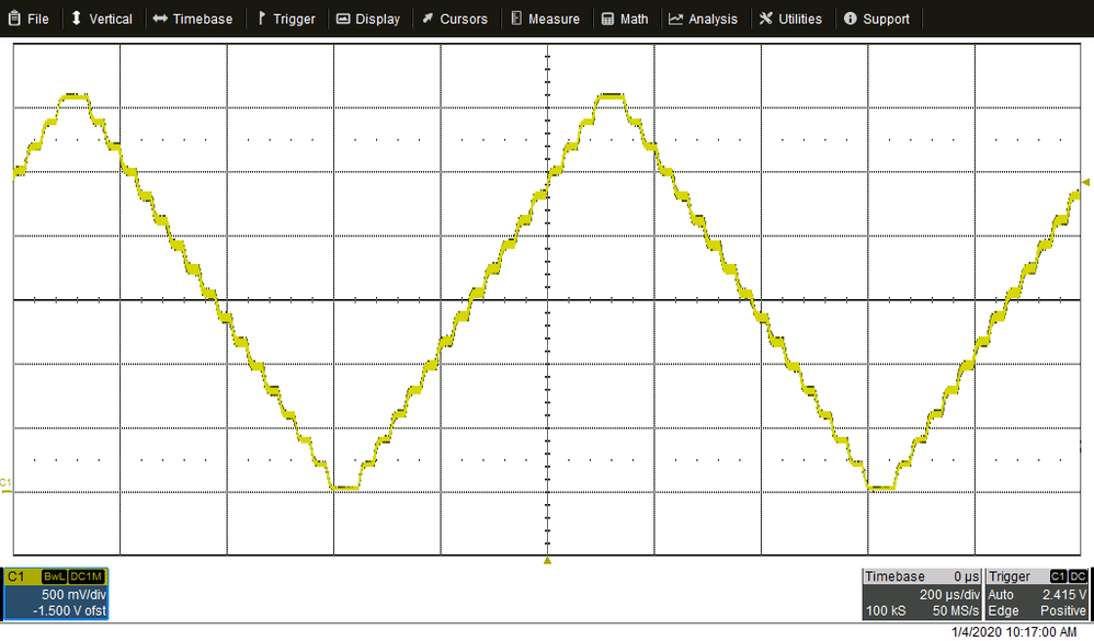

output when "0" placed instead of DitherIndex for AA,BB,CC and DD
