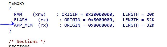

The firmware has to be placed from 0x8008000, i am not sure if i have to create a specific area for this... like this:

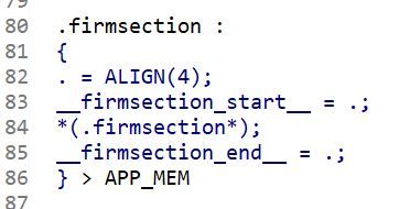

and make section like this...:

Forget creating a new section, just move the FLASH​ one so it has a different start address.
T​here are multiple references in the linker script to direct content and vectors there. Review .MAP file to see where everything is placed.

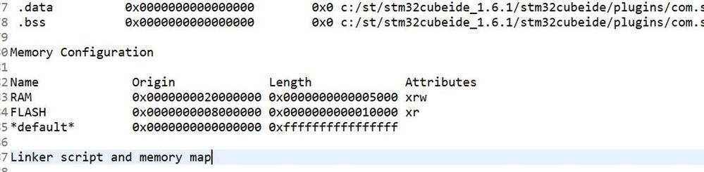

Hi, firstable thanks for your answer, so i have been reviewing the .MAP file and i have found the following part:
Is 0x8000000 the real start address of FLASH?¿ in .id file the origin is 0x8000000, so i don't understant what i have to look up in this file...i never see a .MAP file before so i don't know how to read it
Thanks.

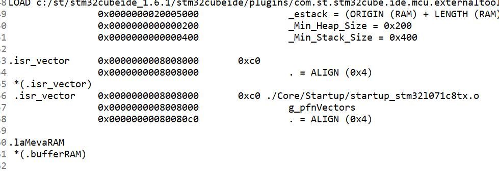

I came up with the idea to see in the .MAP file of Firmware (not the bootloader) and i see that isr_vector starts at 0x8008000
So it is right considering that i jump from the bootloader to that address...am i wrong?¿

1) Make sure that firmware you place at 0x8008000 compiled with FLASH ORIGIN = 0x8008000
