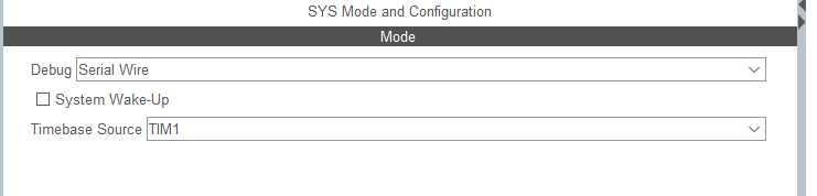

I'm starting a new app with two threads.
If I run as debug step by step it works great.
But if I run free on the board, the second thread not works good (it doesn't blink the required times).
I've use CubeMX for the code generation with Time Base TIM1 as indicated below
What is the problem?
Thanks

‎2019-04-13 1:42 PM
First, You should not use default HAL_Delay() within RTOS threads because it is busy loop.
Second, when kernel is started, both threads are blinking the same LED. Better put osSignalWait() at the beginning of while loops and send initial signal to one of the threads before starting kernel.
