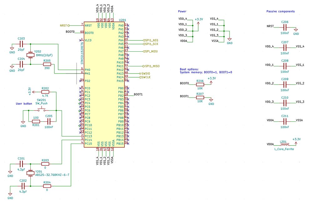

STM32L152RE Schematic Verification
SKuma.101
I am trying to create custom PCB for my academic project. This is the first time i am using an STM32 processor. I will be grateful if someone can verify the schematic for STM32L152RE which i created.
I will be using SWD to flash code to the STM32. The selected boot option is System Memory.
