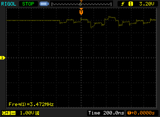

I've checked signals with an oscilloscope. It seems a port responsible for NRST signal is burned out. Sometimes access to an MCU is successful, sometimes not, but a shape of the NRST is far from normal.
