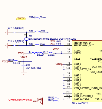

Hello everyone, my programme on Nucleo-F767ZI do not run when I power ON by external power supply. I force to press reset button or power supply st-link by usb cable.
I searched some solutions such as: BOOT0 to GND; or turn on bit POR = 1 in RCC_CSR, but nothing worked.
I don't want to use external circuit to reset.
Anyone can share with me some useful solutions to solve this issue?

Clk is coming from st-link , so you have to power the st-link, to get the 8MHz clk,
or set solder bridges + a crystal connected to F767,
or use only internal HSI clk in your program.
Boot0 at gnd , is always needed, if you dont want to start the internal bootloader.
NRST has to be separated from st-link, if you dont power it; so power st-link, even if you dont use it -
or separate the F767 reset from not powered st-link.
Just look at the circuit of your board, to see, what to do .

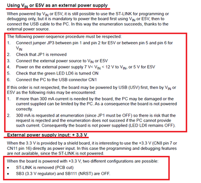

Could I external supply power for st-link by jumper or other pin ? Which pin, pls help?
Please refer to the UM1974 page 23:
For 3.3V power supply: you need to remove SB3 and SB111 to disconnect ST-LINK from the main MCU because it's keeping resetting it.
Sorry no, my external power is 5V, not 3.3V.
So can I remove SB3 and SB111 like 3.3V?
No, so you need to read the first section (VIN/E5V) and apply the described power sequence procedure.
Could I supply external power for ST-Link by others pin (not micro USB port), because I need access micro USB port to debug or read log file

this solved the problem for me:
https://community.st.com/t5/stm32-mcus-boards-and-hardware/nucleo-f767zi-external-power-start-up-problem/m-p/714804#M21087
here in short:
PROBLEM:
The clock for the STM32 is provided by the on board debugger. This clock signal is generated about 2 seconds after the board is power, after which a reset takes effect. By default HSE Startup Timout Value is 100ms, so it timeouts before the clock is available → the board doesn’t start.
that solves it:
  1. If you don't care to much of startup time increase timeout for the HSE to wait for MCO (RCC -> Parameter Settings -> HSE Startup Timout Value (ms))
  2. use the internal clock HSI (if you don’t need accurate clock)
  3. use external oscillator (X3, HSE) - soldering needed
thanks to Elec in the OG post on stack overflow and Rubb to extend it.
