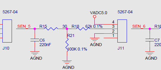

Inter-channel interference occurs when reading multi-channel adc.
kjoo.1
hellow.
I tried to read multiple adc using stm32h743, but I had great difficulty due to inter-channel interference.
I tried to read multiple adc using a simpler "NECTULEO-L073RZ" to find out what the problem was, but the same problem occurred.
Please help me with what the problem is.
I have already tried to read multiple adc using polling mode and interrupt mode.
The code I used below is the DMA adc read code written for "NUCLEO-L073RZ".

Each adc input pin on the "NECULEO-L073RZ" is set as follows:
3V <-> Floating repeat for a0, 0V input for a2~a6, and temperature sensor for a7.

additional information
I was mistaken.
"NECTULEO-L073RZ" allows multi-adc reads to work normally when using the above code.
I will check the stm32h743 setting more and ask again if there are any difficulties.
The adc input hardware configuration of the stm32h743 board I made is shown in the picture below.
I know that there is a big input impedance problem because I omitted opamp by mistake.
In addition, due to the 16-bit adc error, a large capacitor of 220 nf was attached to the adc input terminal.
Could this hardware configuration that I configured cause interference between adc channels?
