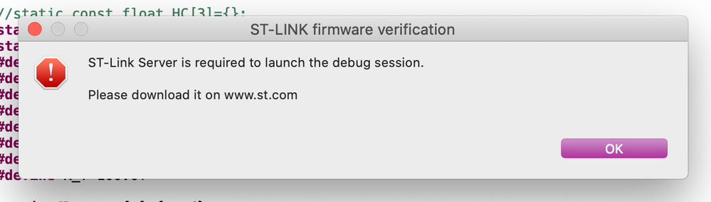

I use STM32cubeIDE on macOS, but I can't successfully debug my firmware connected to ST-link, when I click 'debug', It reveals that 'ST-link is required to launch the debug session.(ST-LINK firmware verification)'. Kindly answer if you know the problem.

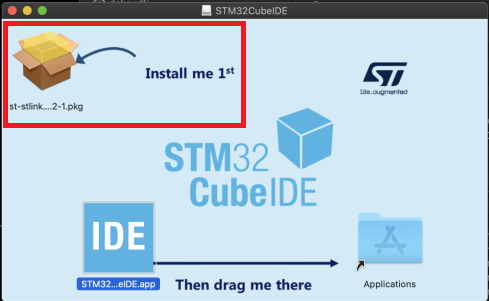

Hi Hyinc.1,
Didn't you forget to install STLink-Server package prior to STM32CubeIDE ?
