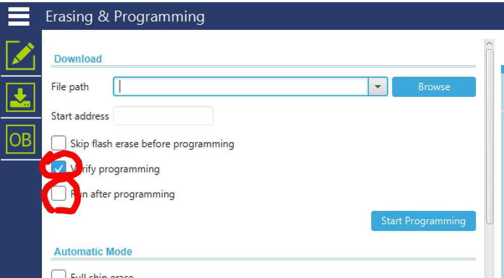

How do you know it isn't downloaded? Use the verify option to verify flashing was successful.

2.Where is the verify option located?
‎2021-08-03 6:47 AM
Are you resetting the chip after downloading code?
There are a variety of ways to verify. Here is one of them. It sounds like you also want to run the program afterwards.

Whenever i select Verify programming, it shows that 'verification failed'. But the downloading is completed.

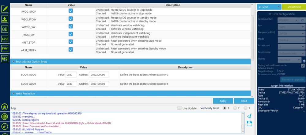

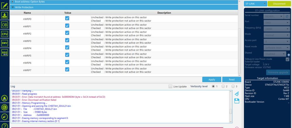

If verification didn't succeed, it's not on the chip.
Check relevant option bytes which could be preventing it from writing. Show the log.

log when i selected ' verify programming':
09:26:45 : STM32CubeProgrammer API v2.8.0
09:30:11 : ST-LINK SN : 002400085553500920393256
09:30:11 : ST-LINK FW : V3J7M2
09:30:11 : Board : STLINK-V3MINI
09:30:11 : Voltage : 3.22V
09:30:11 : SWD freq : 24000 KHz
09:30:11 : Connect mode: Normal
09:30:11 : Reset mode : Software reset
09:30:11 : Device ID : 0x449
09:30:11 : Revision ID : Rev Z
09:30:11 : Debug in Low Power mode enabled.
09:30:11 : UPLOADING OPTION BYTES DATA ...
09:30:11 : Bank : 0x00
09:30:11 : Address : 0x40023c14
09:30:11 : Size : 8 Bytes
09:30:11 : UPLOADING ...
09:30:11 : Size : 1024 Bytes
09:30:11 : Address : 0x8000000
09:30:11 : Read progress:
09:30:11 : Data read successfully
09:30:11 : Time elapsed during the read operation is: 00:00:00.002
09:30:50 : Memory Programming ...
09:30:50 : Opening and parsing file: CHEETAH_30JUL21.bin
09:30:50 : File : CHEETAH_30JUL21.bin
09:30:50 : Size : 55980 Bytes
09:30:50 : Address : 0x08000000
09:30:50 : Erasing memory corresponding to segment 0:
09:30:50 : Erasing internal memory sectors [0 1]
09:30:51 : Download in Progress:
09:30:51 : File download complete
09:30:51 : Time elapsed during download operation: 00:00:00.918
09:30:51 : Verifying ...
09:30:51 : Read progress:
09:30:51 : Error: Data mismatch found at address 0x08006D64 (byte = 0xC4 instead of 0xCD)
09:30:51 : Error: Download verification failed

how to check the option bytes are relevant or not?
will you please help me to know more about option bytes?.
‎2021-08-04 9:19 PM
what should be the option byte boot address?

Not real sure. Try doing a full chip erase and verify the contents of the flash starting at 0x08000000 are all 0xFF.
The "Data mismatch" error certainly shows it's not writing what you intend.
Are any other relevant option bytes set that would prevent writing? Is secure protection off? Is RDP reported as level 0?
Might try a HEX or ELF file rather than BIN.
