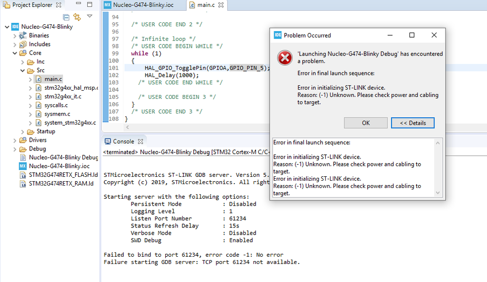

I am beginner. Board: Nucleo STM32G474RE , Has STLink V3E on the board. IDE: STMCubeIDE ; Host OS: Windows 10 Pressing B1 has no effect. LD2 does not blink. getting ST Link Initialization Error - Image in details below.
PKale.1
trying to blink the LD2 on PA5. Getting following error. Please help in resolving.0690X00000BvWEhQAN.png

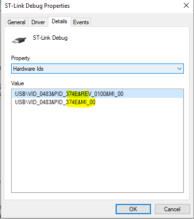

STLINK is installed and showing in Device manager

Looks like the ST-LINK drivers are not installed.
My Details tab reads "STMicroelectronics STLink dongle", but yours shows only generic USB ID.
The drivers can be downloaded seperately (STSW-LINK009).
