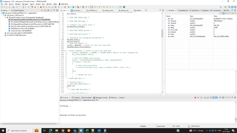

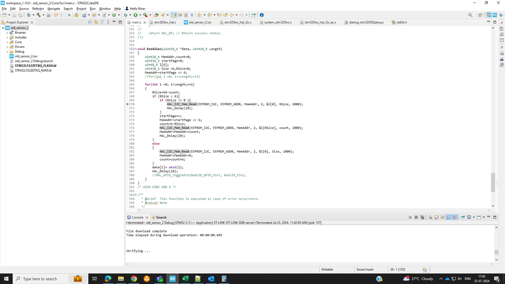

When i try to interface Nucleo-L552ZE-Q with 24C1024 EEPROM i am unable to read data from it.
#define EEPROM_ADDR 0xA0
#define PAGE_SIZE 64
#define PAGE_NUM 512
I have attached the SS of the code.
Here when we get into Read gas function it gets stuck in I2C_RequestMemoryRead(hi2c, DevAddress, MemAddress, MemAddSize, Timeout, tickstart) function of HAL_I2C_Mem_Read function.

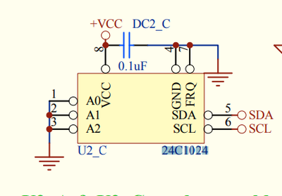

Schematic of EEPROM interfaced is also shown.

KnarfB
Does the I2C connection work at the electrical level?
Does the EEPROM ever acknowledge any I2C request?
Check with a scope or cheap LA.
Pull-Up Rs?
(Low) Speed?
hth
KnarfB
NeevMehta
@KnarfB i don't think it acknowledge any I2c request because when Transmit and Receive commands are fired the results are same
Speed is 400Khz
External pull up is not used.
