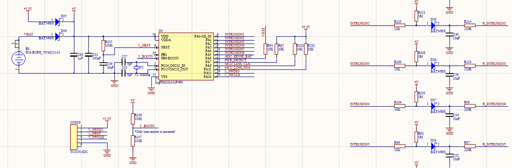

0693W00000GYEMNQA5.pngHi,
My controller still consumes 360µA in STOP mode, i can't figure out why.
Maybe one of the inputs/outputs that leaks current?
I have this IO setup the moment i execute STOP
PA0-PA5 = External interrups up down edgle no pull up of down
PA6 = ADC input
PA9,10,14 = input mode no pull up or down
PA7 = External interrups up down edgle no pull up of down
PB1 = input mode no pull up or down
PB9 = input mode

Maybe your MCU isnt STOP , your code leave STOP and dont go back.
in the full project the wakup happens in an EXTI callback.
But to test i limited the code to only this, so no wakeup can happen, so i can measure the current after stop is executed.
the MCU should stop at HAL_PWR_EnterSTOPMode ..
MM..1
Chief III
Place in while for example gpio check led toggle or other type, because one false interrupt wake your code from stop and ...
In normal code is stop called in while and repeat after do jobs back to stop mode...
