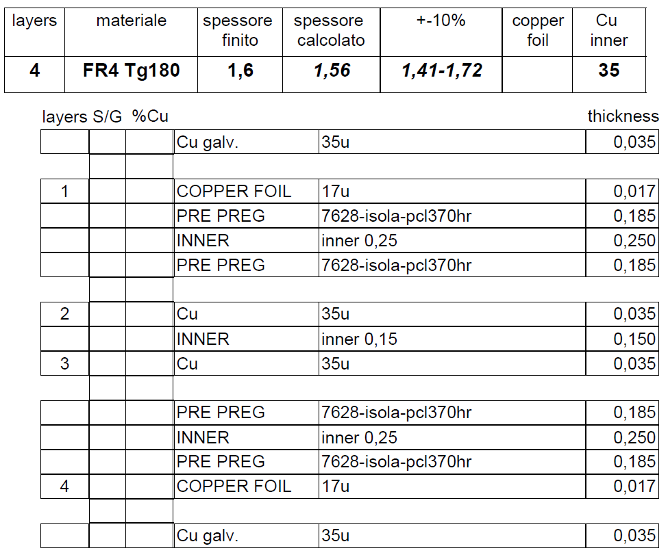

Regarding the reader HF ST25R3911B nucleo board X-NUCLEO-NFC05A1: is possible to have also the stack-up and the infos on built materials in order to have the right impedances ?
Thanks a lot
Travis Palmer
Posted on March 06, 2018 at 08:32
Hi Antonio,
please find below the Layer stack + material used for the NFC05A1.
Since the antenna is mainly on one layer, the stack-up will not influence the impedance so much.
Also differences in the used dielectric characteristic of the material can be compensated by the AAT feature of the ST25R3911B.
BR Travis
