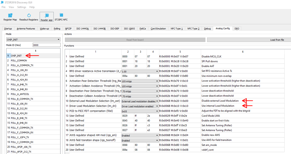

Hi Ulysses,
is there a simple way to enable the EXT_LM signal in the STEVAL-ST25R3916B board through the ST25R3916 Discovery GUI? In the Card Emulation tab I didn't find any option. We have to modify the firmware and reload it?
Thank you
Cla
Hi Cla,
this can be easily done via the GUI, just read from board or load the default file and adapt as per this picture. The setting for Ext_LM is inside CHIP_INIT:
When writing to the board you have also the option to put it into MCU flash to be used as default.
Regards, Ulysses
