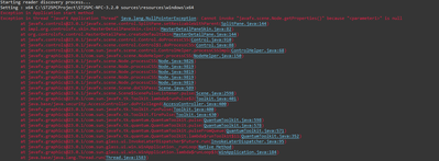

STSW-ST25PC002 run as Java Application loads the application and closes after a second.
shahbaz
I have downloaded the source code of ST25PC-NFC (STSW-ST25PC002) and tried running it as it is. I am running JDK 23.0.1 and also downloaded and extracted JavaFX 23.0.1. Every time I run the MainApp, it loads the application for a second before it gets closed. I get the following exceptions (screenshot attached). 

Hello shahbaz,
Could you please perform those checks in the Eclipse Run configurations?
  1. Open the "Arguments" tab and make sure the VM arguments are set to:
    --module-path "C:\path\to\javafx-sdk-23.0.2\lib" --add-modules=javafx.controls,javafx.fxml,javafx.base,javafx.graphics,javafx.media,javafx.web,,javafx.swing
    (Where you correctly set the path to the JavaFX sdk)
  2. Open the JRE tab and make sure the correct jdk is selected (jdk-23.0.1)
  3. Open the Environment tab and add "path" entry with value:
    ${project_loc:ST25PC-NFC}\resources\windows\x64\;${env_var:path}

shahbaz
Hi Damien,
That works. Thank you for the help.
