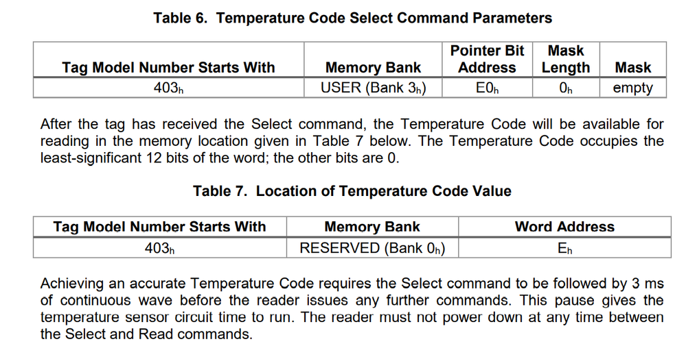

I want the Temperature code. In the application note AN002F38, it is mentioned as below:
"As with the On-Chip RSSI Code, reading the Temperature Code is a two-step process requiring standard UHF Select and Read commands.
1. Send a standard Class-1 Generation-2 UHF Select command with the parameters described in Table 6 to initialize the temperature sensor and calculate a Temperature Code.
2. Send a standard Class-1 Generation-2 UHF Read command to retrieve the Temperature Code from the tag memory at the location given in Table 7."
How can i send select commands and access the particular memory bank so that i can fetch the temperature code and calculate the actual temperature.
How to read a memory bank using SDK source code provided by the ST.
I want to know if a particular API is available to achieve this and in which place in the source code should i use it.

according to the application note the sensor TAG needs 3ms continuous wave after the Gen2_Select command before any further command from the reader.
The actual ST25RU3993 do not allow this out of the box. Although, the Gen2_Select command is a separate API calls the FW
collects Gen2_Select commands and send them direct before scanning for TAGs with the Gen2_Query commands.
There is no delay after the Gen2_Select command, as this is not needed under normal conditions.
To add a delay after the Select before the inventory you need to modify the FW first.
The easiest would be to add a HAL_Delay(3); to the functions
static void inventoryGen2(void) in file evalAPI_commands.c
In this function search for "performSelectsGen2();" and add there a delay of 3ms afterwards
With this fix then do the following to select, inventory and read a TAG
To send a Gen2_Select and a following Gen2_Read command please use the following API functions.
NOTE: The Gen2_Select API do not send any command by itself it only store the "select" request(s) in the FW.
The FW executes then all Gen2_Select commands when running an inventory, as discussed above.
-> This means in your case execute an Gen2_Select, followed by an InventoryRunnerStart and when your TAG is found send a Gen2_Read command.

The parameter target, action, memoryBank, mask, truncation are as defined in the UIHF Gen2 standard.
Accodring to the application note, in case of temperature measurement with this sensor TAG you could use the default initalization values, except the memoryBank.
eg:
STUHFL_T_Gen2_Select Gen2Select = STUHFL_O_GEN2_SELECT_INIT(); // Set to FW default values
Gen2Select.memoryBank = STUHFL_D_GEN2_MEMORY_BANK_USER; // set memory bank
// mask and maskBitLength is empty by default
// Execute the Gen2_Select command
Gen2_Select(&Gen2Select);

In your case the memoryBank must be set to STUHFL_D_GEN2_MEMORY_BANK_RESERVED and the wordPtr must be set to WordAddr 0x0E

browsing through I think there may have been one line missing:
Gen2Select.mode = STUHFL_D_GEN2_SELECT_MODE_CLEAR_AND_ADD;
as the default seems to be STUHFL_D_GEN2_SELECT_MODE_CLEAR_LIST.
BR, Ulysses

When I add the following line,
The reader is not detecting the tag.
When i comment the line, the reader detects the tag well.
What might be wrong?

Hello Lakshmikanth,
User Ulysses is right, the default Gen2Select.mode is STUHFL_D_GEN2_SELECT_MODE_CLEAR_LIST which only clears the internal lists of select commands that
shall be executed before the gen2SearchForTags. The correct Gen2Select.mode is STUHFL_D_GEN2_SELECT_MODE_CLEAR_AND_ADD
Have you tried with some other "standard" Gen2 TAG (use the one that is part of the ST25RU3993 EVAL/HPEV package) to select it and for example read the User memory ?
In the SDK package you find C demo code example to inventory, read and write user memory for 1 selected TAG.
This code is in function "void demo_evalAPI_Gen2RdWr()" in file "STUHFL_demoEvalAPI.c" of the solution ".\Applications\STUHFL_demo\STUHFL_demo.sln"
