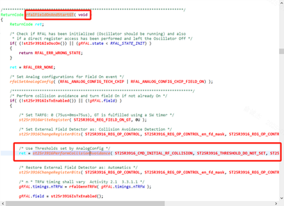

the reason is further down in the code:
    if( (ST25R3916_IRQ_MASK_CAC & irqs) != 0U )        /* Collision occurred */
        err = RFAL_ERR_RF_COLLISION;
    else if( (ST25R3916_IRQ_MASK_APON & irqs) != 0U )
        /* After APON wait for CAT interrupt, indication field was switched on minimum guard time has been fulfilled */
        irqs = st25r3916WaitForInterruptsTimed( ( ST25R3916_IRQ_MASK_CAT ), ST25R3916_TOUT_CA );
        if( (ST25R3916_IRQ_MASK_CAT & irqs) != 0U )                             /* No Collision detected, Field On */
            err = RFAL_ERR_NONE;
Neither CAC nor APON interrupt are coming -> Is your interrupt handling in MCU working properly? Did you enable ST25R_SELFTEST and successfully run through the initialization?

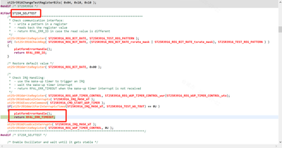

I turned on ST25R_SELFTEST and ST25R_SELFTEST_TIMER, and the initialization failed.Does this mean that the fault lies not in the software but in the hardware?
zhangxixun
Hi

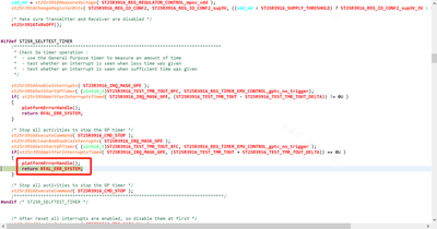

I use ST25R_SELFTEST and ST25R_SELFTEST_TIMER to check my program,but both failed.
ST25R_SELFTEST returns RFAL_ERR_TIMEOUT,
ST25R_SELFTEST_TIMER returns RFAL_ERR_SYSTEM (2nd).
What is the reason for this error, and how should I solve this error?
Thanks, zhang

please read the comments around these places. Here the code will test
  1. if interrupts are received and signaled to the main layer
  2. if the timer handling is about right. Not too fast and not too slow.
If you fail on any of these you need to look into your ISR and your timer porting.
