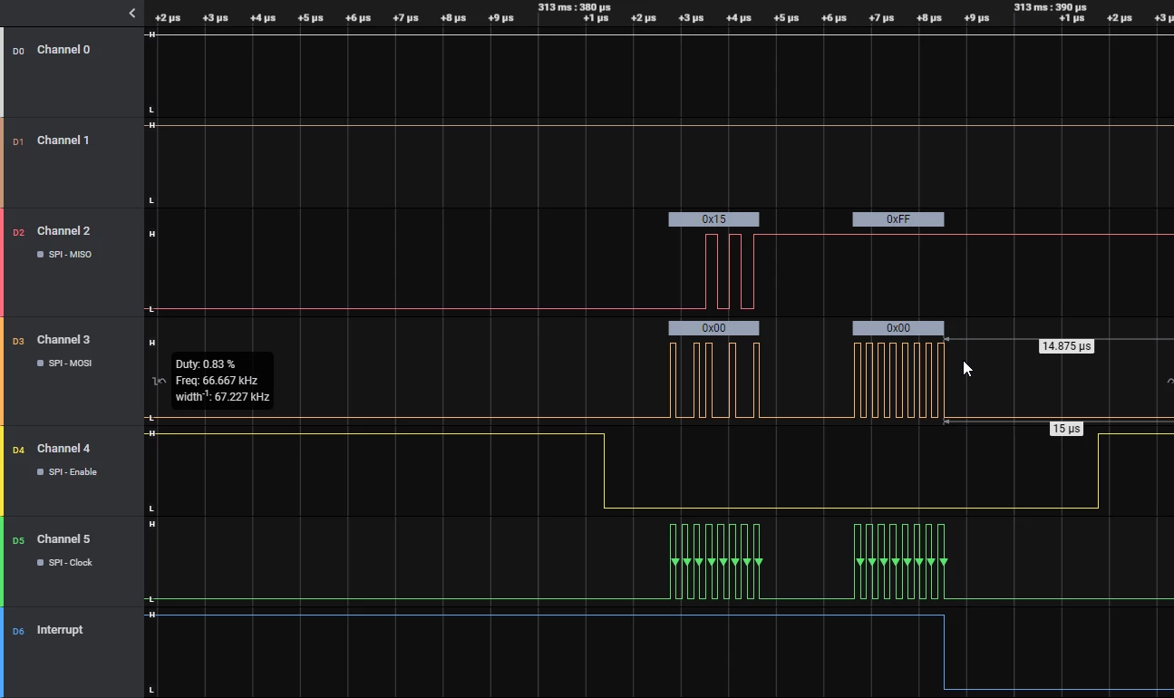

In platform.h I have set the platformGpioIsHigh () as (u1_Get_MCAL_Port_PinSts(port, pin) == GPIO_PIN_SET) for renesas .In porting of platformGpioIsHigh what else we have to take care?
I have attached the logic analyzer file of spi and interrupt.

looking at the trace the SPI in the logic analyzer is incorrectly configured. Below picture has it properly configured (signals and trailing edge).0693W00000SvEpJQAV.pngIt also shows that the interrupt service routine is not being executed (INT line gets cleared by masking the interrupts(15-ff). The routine seems to try to enable the field repeatedly.
Better to concentrate only on the initialization routine in the beginning.
