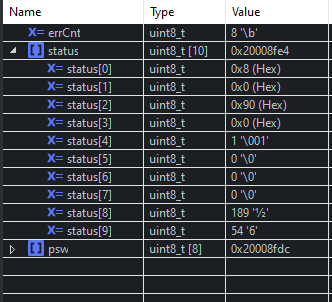

2021-08-20 7:19 AM
uint8_t errCnt, status[10];
iDrvNfc_I2C_Read(I2C2,ST25DV_ADDR_DYN_REG_READ_I2C,ST25DV_EH_CTRL_DYN_REG,(uint8_t*)&status[0],1); // Read vcc status
if (!(status[0] & 1<<3))
++errCnt; // ERROR VCC is not present
uint8_t psw [ 8 ];
memset (&psw, 0 , 8 ); // psw = 00000000 (8byte)
iDrvNfc_I2C_Read(I2C2,ST25DV_ADDR_SYST_READ_I2C,ST25DV_MB_MODE_REG,(uint8_t*)&status[1],1); // 1 - read the MB_MODE bit in the MB_MODE register
if( ! (status[1] & 1) )
e_psw e_psw_t = iDrvNfc_I2C_Present_Password( psw ); if(e_psw_t){}; // 2.1 - if the I2C_SSO is not set, present the i2C password. Check the I2C_SSO bit in I2C_SSO_Dyn
iDrvNfc_I2C_Write(I2C2,ST25DV_ADDR_SYST_WRITE_I2C,ST25DV_MB_MODE_REG,(uint8_t*)1,1); // 2.2 - set the MB_MODE bit ( (@0x000D, slave address 0xAE)
iDrvNfc_I2C_Read(I2C2,ST25DV_ADDR_SYST_READ_I2C,ST25DV_MB_MODE_REG,(uint8_t*)&status[2],1); // 1 - read the MB_MODE bit in the MB_MODE register
iDrvNfc_I2C_Write(I2C2,ST25DV_ADDR_DYN_REG_WRITE_I2C,ST25DV_MB_CTRL_DYN_REG,(uint8_t*)1,1); // 4 - set MB_EN in MB_CTRL_Dyn (@0x2006, slave address 0xA6).
iDrvNfc_I2C_Read(I2C2,ST25DV_ADDR_DYN_REG_WRITE_I2C,ST25DV_MB_CTRL_DYN_REG,(uint8_t*)&status[3],1); // - read the MB_EN in the MB_CTRL_Dyn

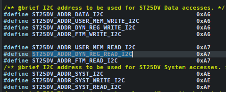

2021-08-20 7:51 AM
are you sure that Address AEh/AFh are being used when writing/reading MB_MODE register? Can you connect a logic analyzer and provide a trace?
Rgds
BT
2021-08-20 8:14 AM
Thanks for helps i will try logic analyzer or i can try new hardware
