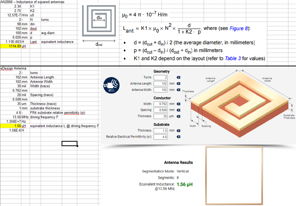

ST sells ST25TV Type 5 tag chips with a 23pF / 99.7pF option. What bearing does that option have on read range and other interactions with a reader like the ST25R3911B? No info that I can find in the datasheet.

My first thought was to compare the square spiral antenna model with the result of the ST's eDesign antenna. And the numbers produced are about three orders of magnitude different. Am I missing something?0693W000003QckGQAS.png
