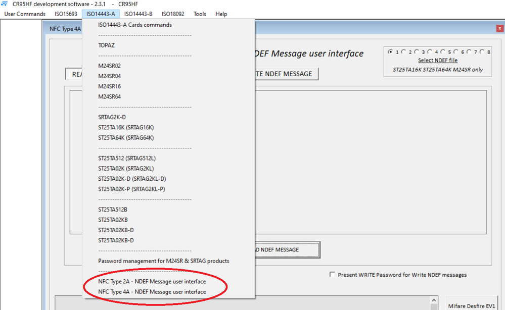

I am using NDEF tag emulator in my Andriod phone. But I Can not read a simple NDEF message with my evaluation kit (NDEF type 4A).
When clicking "READ NDEF MESSAGE" a list of service pops up on the phone, I select the one for the emulator and nothing more happens.

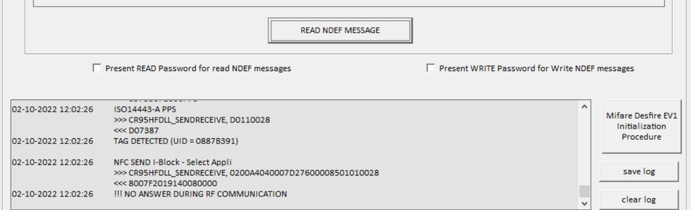

0693W00000JPHjAQAX.pngFull log:
02-10-2022 12:07:18	RESET SPI
			>>> CR95HFDll_RESETSPI
			<<< 8000
02-10-2022 12:07:18	ECHO
			>>> CR95HFDll_ECHO
			<<< 5500
02-10-2022 12:07:18	RF OFF
02-10-2022 12:07:18	CR95HF CONFIGURATION : ISO14443-A protocol
			>>> CR95HFDLL_SELECT, 02000280
			<<< 0000
02-10-2022 12:07:18	ISO14443-A : CONFIG
			>>> CR95HFDLL_STCMD, 0109043A005804
			<<< 0000
02-10-2022 12:07:18	ISO14443-A : INCREASE DEMOD GAIN
			>>> CR95HFDLL_STCMD, 010904680101D3
			<<< 0000
02-10-2022 12:07:18	RF ON
02-10-2022 12:07:18	ISO14443A REQ-A
			>>> CR95HFDLL_SENDRECEIVE, 2607
			<<< 0400
02-10-2022 12:07:18	ISO14443A ANTICOL 1
			>>> CR95HFDLL_SENDRECEIVE, 932008
			<<< 08869A7C68
02-10-2022 12:07:18	ISO14443A SELECT 1
			>>> CR95HFDLL_SENDRECEIVE, 937008869A7C6828
			<<< 20FC70
02-10-2022 12:07:18	ISO14443-A RATS
			>>> CR95HFDLL_SENDRECEIVE, E04028
			<<< 05788071006F7C
02-10-2022 12:07:18	ISO14443-A PPS
			>>> CR95HFDLL_SENDRECEIVE, D0110028
			<<< D07387
02-10-2022 12:07:18	TAG DETECTED (UID = 08869A7C)
02-10-2022 12:07:18	NFC SEND I-Block - Select Appli
			>>> CR95HFDLL_SENDRECEIVE, 0200A4040007D27600008501010028
			<<< 8007F2019140080000
02-10-2022 12:07:18	!!! NO ANSWER DURING RF COMMUNICATION
Any guess about what is happening?

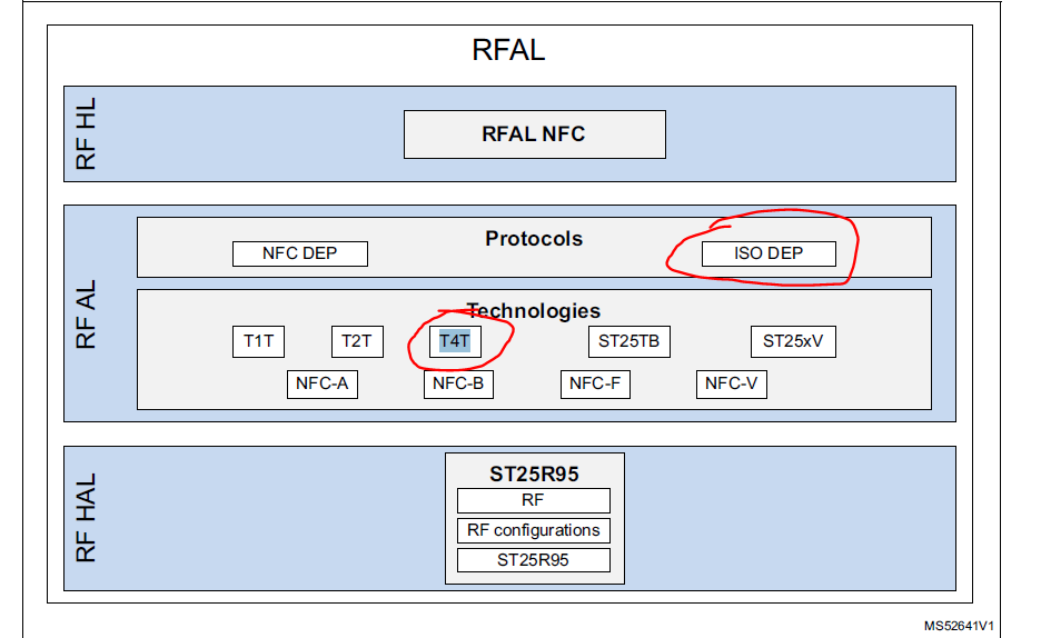

One more thing. In terms of RFAL, which would be the stack to use:
T4T and ISODEP?

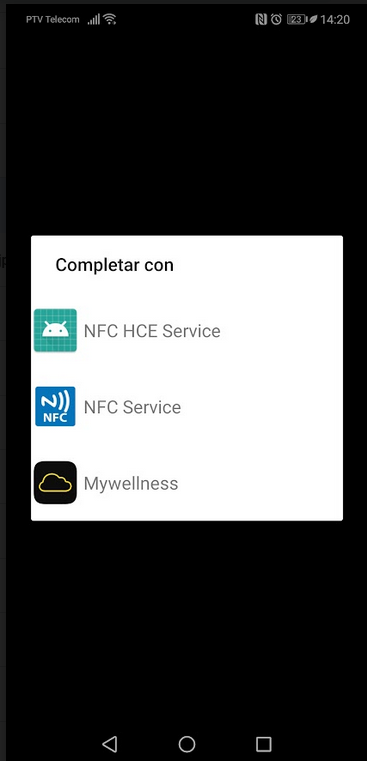

App: "NDEF Tag emulator"
Phone: Huawei P20 Lite
Android: 9.1.0
Yes, app is running foreground and saying "Emulating...."
0693W00000JPJHqQAP.pngPopUp arises as there are several compatible services (My guess)
0693W00000JPJHCQA5.pngNFC Service is the logo of the App NFC Tag emulator
Brian TIDAL
I used to have the same popup on my personal Android phone:
go to the parameters/settings menu in Android, then NFC payement & contactless then contactless payement then Others and deselect all except NdefTagEmulator.
The popup should not appears any longer and the NDEF can be read
