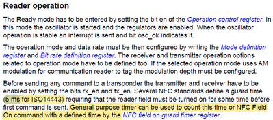

Another issue is that NFC08A1 datasheet recommends to set NFC field on guard timer register to 5ms (0x21 value). The example keeps this value to 0 even though the NFC type A feature is used, I tried to set this value but for some reason this register changes to 0 without my permission. Is It mandatory to set this value for NFC type A communications? What is the reason why it don´t allow me to change the register value?
