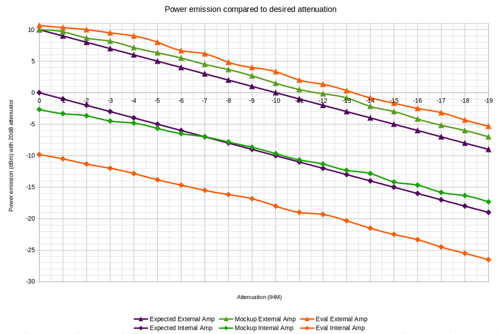

TCrav.1
Hello Nick, Thank you for your reply.
We finally managed to perform tags inventory and reading with our modified HPEV-board.
But we still have some questions on the power output.
We have redone the output power measurements. We use a spectrum analyser connected to the output port and we measure the power output during a tags inventory of several seconds/rounds (Europe profile):
With our modified HPEV-board:
  • With the Internal PA, at 20dBm (Output level 0), we measure 17.33 dBm
  • With the External PA, at 30dBm (Output level 0), we measure 30 dBm
With the non modified HPEV-board:
  • With the Internal PA, at 20dBm (Output level 0), we measure 10.17 dBm
  • With the External PA at 30dBm (Output level 0), we measure 30.67 dBm
You can find below the measurements we did. The "Eval" board is the non modified one. The "Mockup" board is the modified one.
Here is our spectrum analyser configuration:
  • Center freq: 866,9MHz
  • Span: 10MHz
  • RBW: 100kHz
  • VBW: 300kHz
  • sweep: auto
We are surprised by the results obtained with the non modified HPEV board. Is there an issue in our test procedure, test set up, or with our evaluation board?
Best regards,
Thomas.

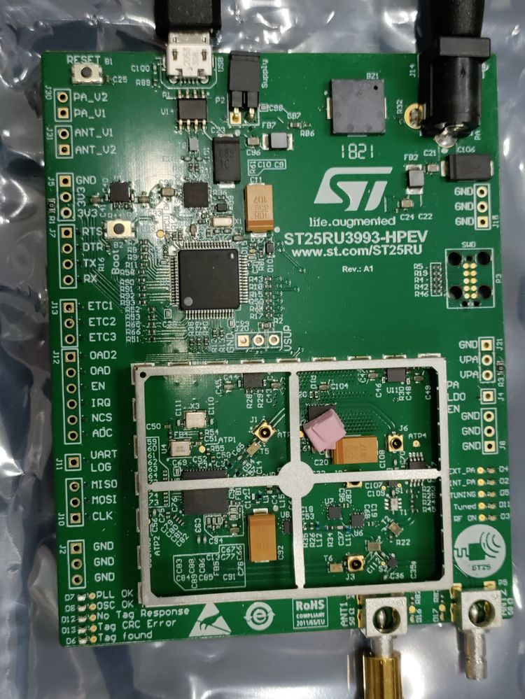

Bart Herse
Senior II
Hello Thomas,
with the information provided it is hard to tell why the EVAL board shows a lower output power.
I suggest you share screenshots of the Reader configuration/settings dialog and the register map.
A high-res. picture of the board itself helps as well.
To narrow down on the source of the problem you could measure the internal PA output power at J9 which is located between the Balun and the PA switch. Check if the output power here is at an expected level.

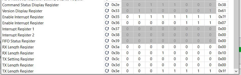

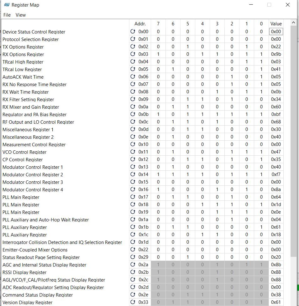

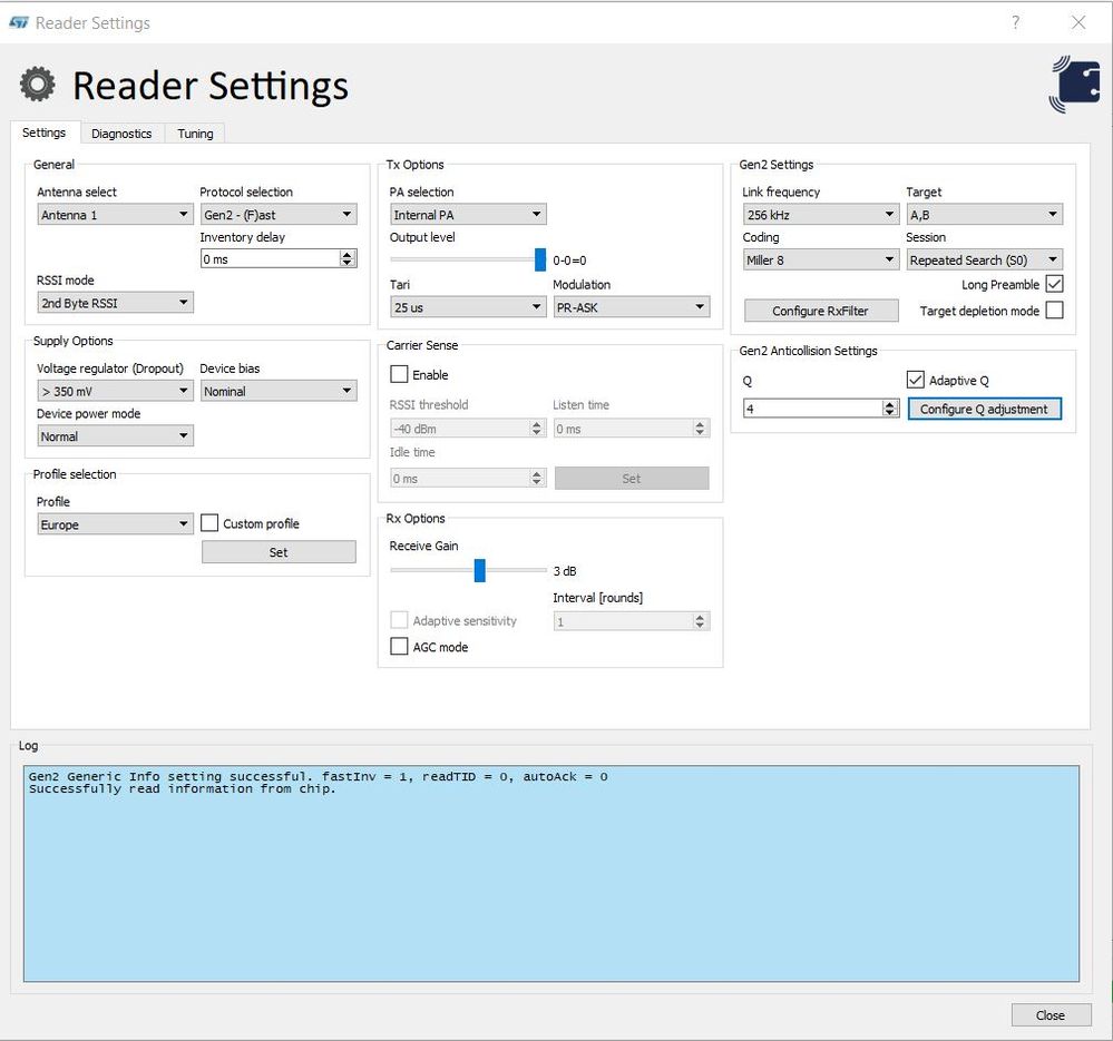

TCrav.1
Hi Bart,
Here are the screenshots you needed.
We don't have any test adapter (MS-156-HRMJ-2) to measure power at J9, can you help us with what we have provided so far ?
Thanks,
Thomas.0693W00000LzT22QAF.jpg0693W00000LzT27QAF.jpg0693W00000LzT2HQAV.jpg0693W00000LzT1xQAF.jpg
Bart Herse
Senior II
Hello Thomas,
thanks for sharing this information.
Nothing in the settings of the reader would explain to low TX power levels in your measurements.
With regards to measuring the power at J9:
Can you check if any soldering/assembly problems are apparent on the components between the reader IC, J9 and S1.
If no obvious issue can be found we should discuss sending-in the board for a check.
Can you confirm that no modifications were done on the board?
Cheers,
B
