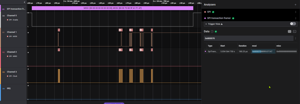

I am using ST25NFC_Embedded_Lib_ST25R3916_1.4.0 on
STM32L5 discovery board with X-NUCLEO-NFC06A1
And I have no problem to detect and read ST Tag (always correct), but if I use NXP tag I have super strange behavior.
On bare-metal application, it works on ST+NXP tag.
But on our application that use DMA SPI, and it's 4x slower on CPU I can read st tag but NXP no. He didn't say that he detected anything. From code debug I founded that resolving of NFC conflict always return BUSY and it all. I removed DMA on SPI and still (as the DMA for that short operation give some overhead), but there is a problem. Code is mostly the same, lib is just copied.
For me, it looks that this library have a problem on working on more restricted environment. Could you say how to make it working?
PS> Before removing DMA I had a problem that protected areas in that lib prevented for getting to interrupt.
in above trace it was getting to RFAL_NFCA_CR_SEL_TX with the NFC-A tag. I understand that it will not be easy for you to debug our driver logic. But what you could still do is debugging the SPI driver calls (using logging) vs the bytes observed using logic analyzer.
I assume you will need to first improve the signal quality as observed on the logic analyzer and then look at the data bytes. Ideally you could straight look at the unique pattern as above which was present in both traces.
If this is not possible then I think it should be possible to use a diff tool to see differences in logic analyzer output (exported/sent to terminal) vs logs which you could add to your SPI driver.
Good hunting!

can you connect a logic analyzer on SPI (CLK/MOSI/MISO/CS) and IRQ_3916 and provide the trace when you try to poll the tag.

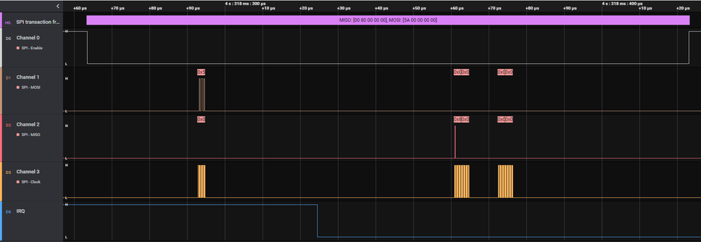

I added saleae analyzer output for working/not working device

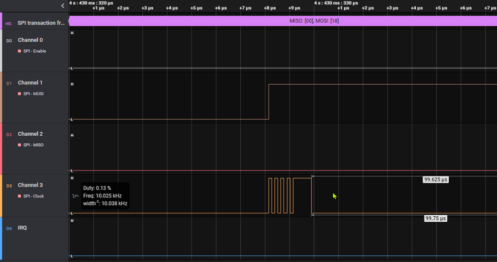

I reviewed the traces (also downloaded and enabled the SPI transaction framer).
Reviewing the traces I see not soo good signal quality on the signals:
  • Weird signal on IRQ line: going low prematurely and ringing 0693W00000WIIYyQAP.png
  • One time the IRQ line (during init) was staying high 100ms, not handled by ISR
  • To the question of ST tags working vs NXP tags: The used ST tags were NFC-V whereas the non-working were NFC-A
  • There seems to be an issue in your porting as the command bytes in NFC-A ends up wrong on SPI bus:0693W00000WIIclQAH.pngIt should be RFAL_NFCA_CMD_SEL_CL1 (0x93) but ends up as 0x00: 0x800070 instead of 0x809370. This is why the tag does not respond to the select on first cascade level. Please debug the code to see why the 0x93 does not get out.
I also recommend to look into signal integrity - shorten your flying wires. Twist the wires and move away perpendicular to the antenna.
Best Regards, Ulysses
