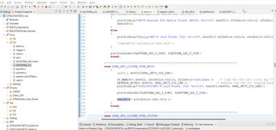

no response interrupt keep on triggering continuously after some time. please help in knowing the reason for this scenario.st25r3911b ic we are using and tag we are using st25tv

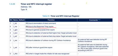

the demos as is are running and reading NFC-V tags. So the default delivered binaries should work, do they? Did you port it to a different MCU? Any other changes? In case this happens only after porting - please provide logic analyzer traces.
The no response interrupt is normal when there is no tag. Even in case the tag is there this error may still happen depending on the command sent.

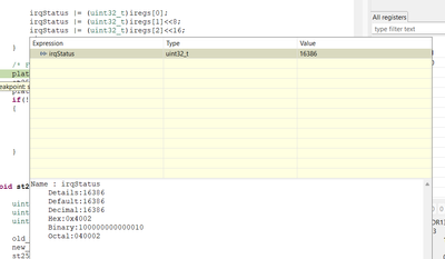

we are using the example code. We would like read NFC-V type tag with ISO15693.please find the attached screen shot.
salugu
this error keep on triggering even after tag is removed
