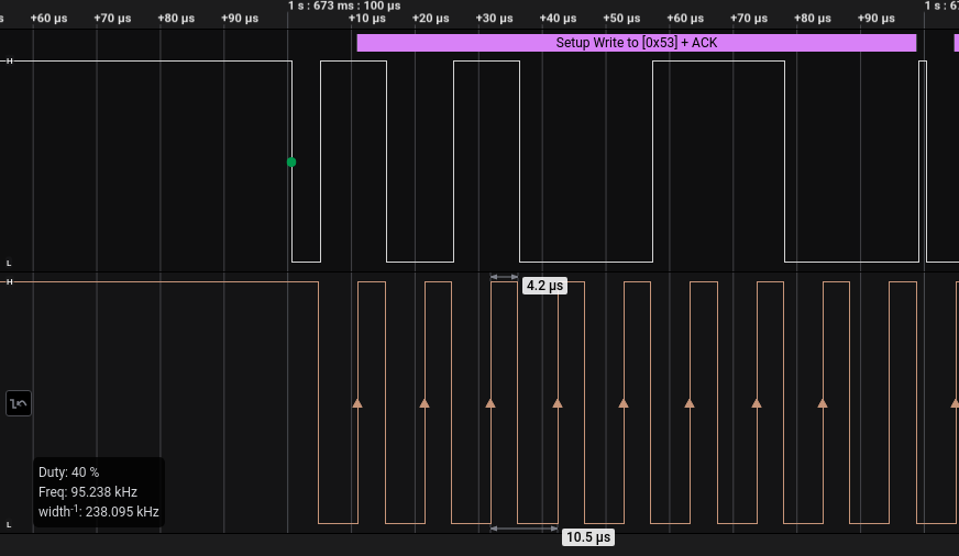

I can write NDEF payload to ST25DV via I2C and read it back via I2C and using NFC Tools App.... This works fine and perfectly. I can also write NDEF messages using NFC Tools, and read back what I wrote no problem.
The exact issue comes up when I try to read what I wrote to the ST25DV tag (using NFC Tools) using NFC. I don't get garbage exactly... i do get some correct bytes out (the NDEF header is mostly correct), but the payload data portion seems corrupted. What i get from reading via I2C is repeatable...as in I read the same corrupted data with every read. If I write a new NDEF message via I2C, then the corruption no longer exists and I can read back the NDEF message that I wrote (via I2C) without issue.
NFC Tools App allows you to read the memory from the ST25DV. The memory I am reading doesn't match what I read via I2C after I write to the ST25DV using the NFC Tools App. The NFC Tools App seems to have access to a different memory then what the I2C domain does, yet the I2C domain is able to easily write into the NFC domain. This is of course an abstraction for understanding my issue.
There is nothing actually wrong with the ST25DV unit I have on the surface level. It works fine with an Arduino running on STM32L476RG using the st25dv arduino driver (github: stm32duino/ST25DV) without any issues so there as to be some sort of issue with my setup....
In my setup I am using a custom board with Muratta CMWX1ZZABZ-078 that has a STM32L072 on the SoC. The board "B-L072Z-LRWAN1" makes use of this SoC. My I2C lines have other peripherals on it such as a BME280. I can read and write to the BME280 without a problem. My project is based on ( github: Lora-net/LoRaMac-node), of which I inherited all the I2C / Clock settings / API from (building it as if it was a B-L072Z-LRWAN1). I have tried using I2C speeds of 100kHz and 400kHz.
I have an I2C logic analyser. Here's an example of successful read/write using I2C only. I make an NDEF text entry with the string "TestEntry123". Too be clear these transactions work as expected.

Here is the actual I2C signals... again this is the working signals. running at 100kHz.
0693W00000NqDG8QAN.pngWhen read from NFC Tools, 1 record is found. UTF-8 (en) : text/plain "TestEntry123"...as expected. Great that works.

Here is the I2C signal.
0693W00000NqDM6QAN.pngCloser look at the clock.
0693W00000NqDMaQAN.pngAny help/tips on this issue would be appreciated. Let me know if there is any other kind of analysis you would like to see to help me get to the bottom of this.

I quickly did an analysis of the expected pattern vs the received pattern on I2C:
1    2    3    T    e    s   t    E    n     t    r    y
0x31 0x32 0x33 0x54 0x65 0x73 0x74 0x45 0x6e 0x74 0x72 0x79
0x10 0x20 0x33 0x54 0x45 0x62 0x74 0x40 0x68 0x30 0x32 0x31
If you inspect the hex digits you can see that line 3 compared to line 2 shows only bits going from 1->0 and never from 0->1.
Possible explanation for this could be two I2C devices driving data. I2C with its pull-ups and devices only driving zeroes allows exactly such behavior.
When inspecting as suggested by JL. Lebon using a scope you could possibly see this: Some 0 would be stronger / lower than others when both devices are driving a 0. But you need to watch out for such.
Best Regards Ulysses

I2C is a quiet simple system and from the other post about this topic, I understood that you already checked the bus and pulls-up resistors. So I think I2C will have less chances to be the root cause. To be sure, the only way would be to put an oscilloscope on SDA/SCL lines and check if the transaction is OK where you read garbage bytes (you can trust an oscilloscope much more than a logic analyzer). With a scope you can precisely check that the timings and the voltage levels are good.

I do have a wild idea that the issue could still be on I2C. I have seen in the past cases where I2C devices incorrectly "felt" addressed by data going/coming from other devices and started garbling data on the I2C bus.
So I would also make a trial to disconnect the other devices from the I2C bus and see if the issue persists.

I have found that my EEPROM M2402 was interfering. I pried it off my PCB and now I can read from the NFC device properly.
