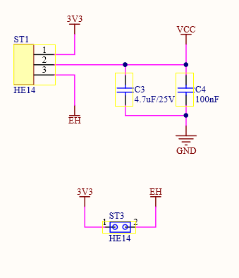

If you have a look on the schematic of the antenna board provided with the kit, you can see that the Energy Harvesting pin is on the pin 2 of the 14 pin connector.
https://www.st.com/resource/en/schematic_pack/st25dv-ant-c5-schematics.pdf
You can connect you own board with this pin connected. On the motherboard side, it is the pin 2 names "EH".
Regards

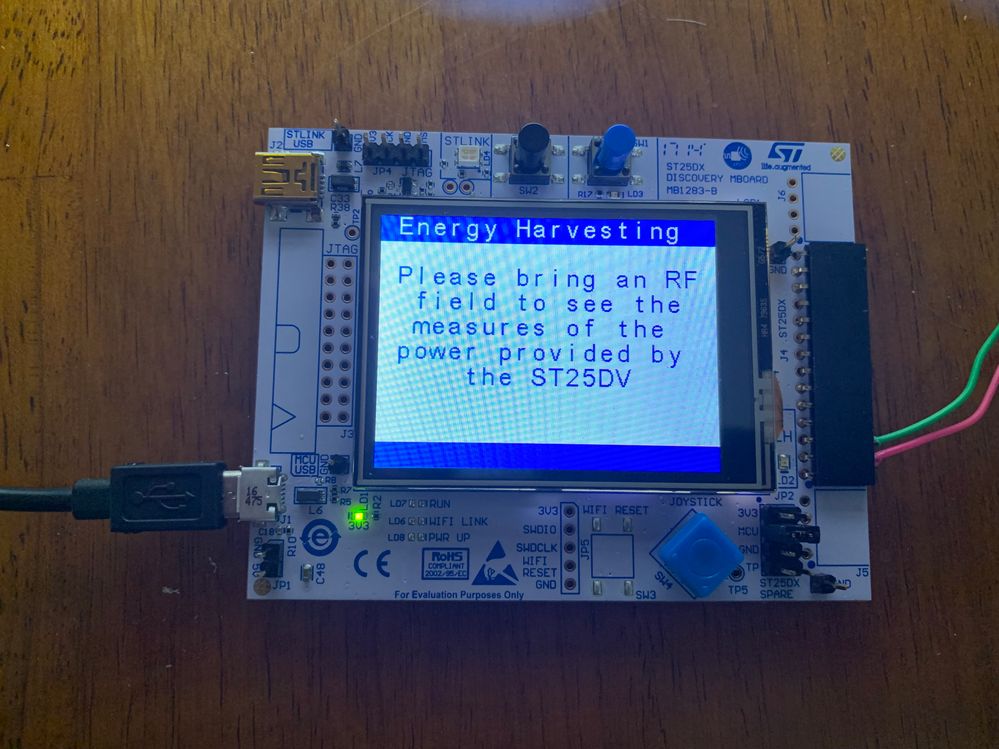

Dave,

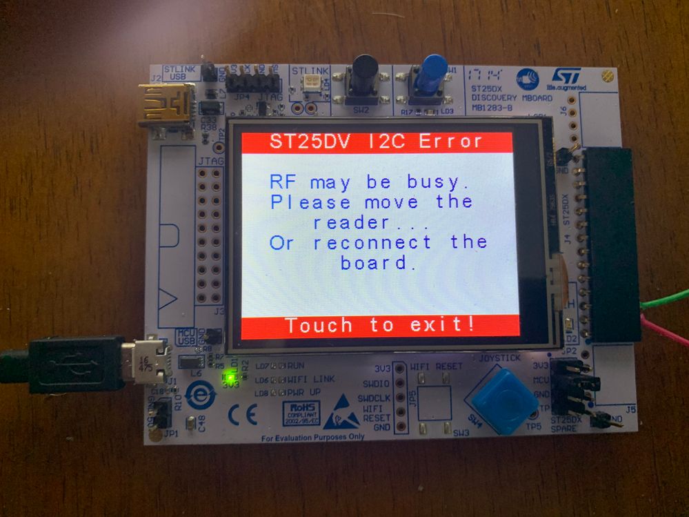

Thank you!  Connecting the tag’s harvesting “Vout” to pin 2 (the Energy Harvesting pin) on motherboard’s 14 pin connector and the tag’s Ground to pin 3 on the 14 pin connector works!
Two questions:
  1. To get to the Energy Harvesting function, I must first power-power up the motherboard with the ST25DV_Discovery_ANT_C5 connected and select the Energy Harvested function, otherwise I get “ST25DV I2C Error”.  Is it possible to remove this step (i.e., boot directly to Energy Harvesting?)
  2. Is a “ST2DV Demonstration” firmware update available for the kit?  I am running Version 1.0.5.
