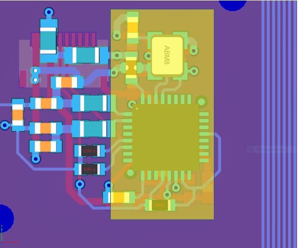

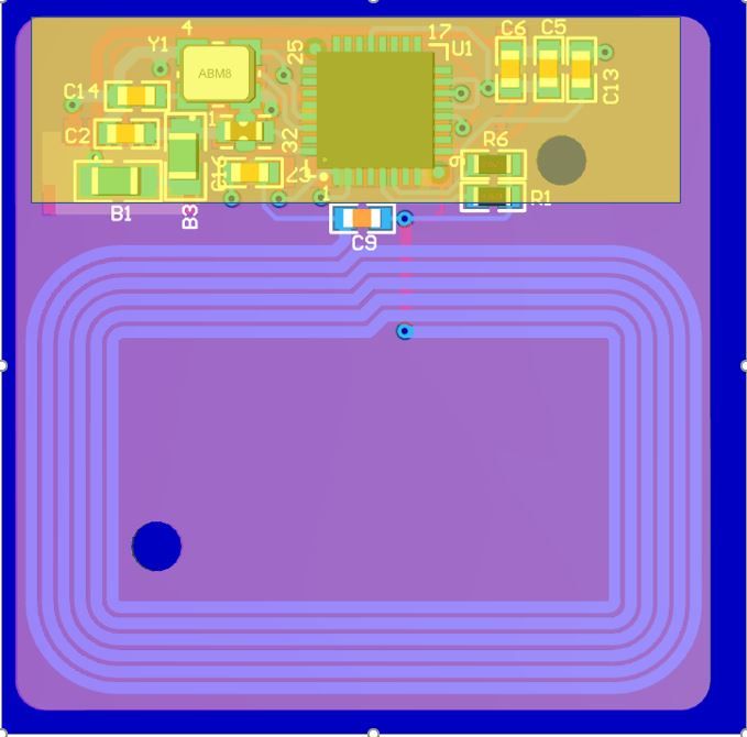

I am using the following configuration.
protocol :- ISO/IEC 14443 Type A tags
TimerW value :- 0x58
Modulation Index and Receiver Gain :- 0xD0
Reader Antenna Dimensions
L=28 mm
W =28 mm
No of turns=3 turns
Find attached diagram for designator reference
C11=180pF
C12=180pF
C2=180pF
I am also using an Low pass EMI filter
L01=L02="Part number=742792042"
C01=C02=180pf
I have tried fine tuning with various capacitor combinations.
I got slightly better range of 1.3 cm when replacing C11 and C12 with 1nF capacitor.
otherwise the range is around 0.9 cm.
For Tag i am using Keyfobs tokken type tag.
Please help me understand how to obtain greater range?
Is it by changing the modulation and gain configuration?/tag used?/capacitance values? or should i redesign the antenna.?
I designed a small antenna as per edesign suite to fit CR95hF and antenna in my 30mm x 30mm PCB such that the circuits and components are in the centre of the PCB while Antenna is on the outer circling the circuit.
Kindly help me out.
Regards
Gokulan

Hi Gokula,
thanks for sharing your new designs.
Keeping copper ground plane as shield around components is generally recommended, particularly arounbf cristal oscillator and tuning circuit. Don't know you design rules like clearance around tracks, but it is possible without living too much dead copper, you may try to restore a bit grounf plan on design with components out of the antenna. you may start ground plan on a line B1-R1 (to leave 2mm minimum between groung plan and antenna, up to the PCB border close to the crystal.
For designs with components inside the antenna, you may just put some ground plan to shield the crystal oscillator and CR95HF.
see pictures below, ground plan suggestion in yellow.
best regards,
Henry Crane

The reason my antenna is not big is because my client want it in a very small foam factor, this is for an wardrobe lock application. they gave me a maximum PCB size of 30*30 mm. Kindly let me know if i can re-route the PCB with a different antenna to get much higher reception with the same 30 x 30 mm size.
Regards
Gokulan
Hi Gokulan,
to me (being a software engineers) increasing from 28x28 to 30x30 I would not expect a major improvement. As Brian has performed also some tests below on X-NUCLEO-NFC03 which give 30mm as opposed to your 13mm we think that improvement could be possible. He is discussing internally with people being more experienced with antennas on possible reasons and what you could try.
In general there are always two possible reasons why the read range is limited:
  1. The output power is not sufficient to power the tag -> lower impedance / change antenna
  2. The tag is powered and answering but the reader does not receive/decode the tag signal. -> Inspect noise and the receive path
To differentiate 1. and 2. you can use an oscilloscope probe where you connect the ground wire to the tip (building a loop) and put it in free air close to the tag antenna. You should be able to see/trigger on the reader modulation (WUPA in OOK) and some 90us later the tag modulation (subcarrier of 848kHz imposed on the 13.56MHz).
Regards, Ulysses
P.S. I assume you are currently using your antenna in free air. Please beware in a wardrobe lock you may have metal parts close by which may have a strong negative effect on your antenna.
