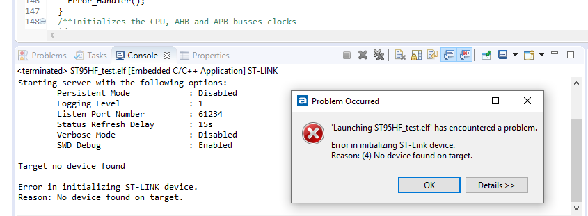

ok right, i get it, can i really use atollic IDE to debug EVAL-ST95HF board? because i created a new project from MCU (STM32F103RGTx) in CubeMX and then i built project into Atollic, but when debugging i get this message error0690X000008BbHUQA0.png
and when I use STM32 ST-Link Utility or STM32cubeProgrammer, i Successfully to download program but i can't debugg step by step. my goal is to build et debugg step by step to figure out how code is made, do you have any idea how to realize that or which tools i have to use without using full keil uvision5 version?

​Hi,
which probe do you use (i.e. a ST-LINK/V2 probe with the 20 pins cable or the ST link module from a Nucleo-64 with wrapping)? Is the SWD NRST pin properly connected?
Can you check that SWD option is selected in your debug configuration?
Can you try to perform an Erase Chip with ST-LINK utility before lauching Atollic TrueSTUDIO?
Rgds
BT
P.-S. : on my side, using Atollic TrueSTUDIO Version: 9.3.0, I am able to compile, link and debug the FW through ST-LINK/V2. In order to narrow down your issue, I would suggest you create a very simple project with STM32CubeMX enabling the LED1 and the SWD and check that you able to connect the debugger

i'm using ST-Link/V2 probe, i managed to debug my new project with CubeMX, i had forgotten setting SYS Mode and configuration ( set Debug Mode to serial wire) when i generated the project. then i unzipped the EVAL-ST95HF project from ST website and imported it into atollic. When i build, i have multiple errors such as:
C:\users\ProjectDirectory\filename_where_the_probleme_is_located.h: error: fatal error no such file or directory #include "filename.h", i thought the problem was that i forgot to include all necessary path in Project->properties -> C/C++ General->Includes is it better? I've a few errors
or can you explain me what is the different steps i have to do, when you want to use a eval board project that have done with keil into Atollic please?
