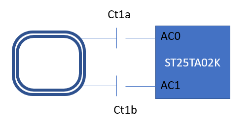

The 1462360131 total impedance is 7+342.1j => 7Ohm in series with La_eq=3.89µH at 14MHz which too high, based on explanation above. The 14MHz tuning frequency can be however reached by inserting two equal series caps ( to balance the impedance on both sides of the antenna) as described below:

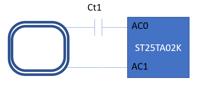

Ct1a and Ct1b are equal. CT1a=CT1b=2xCT1 where CT1 is the theoretical unbalanced capacitor is series between the antenna and the ST25TA to adjust resonant frequency:

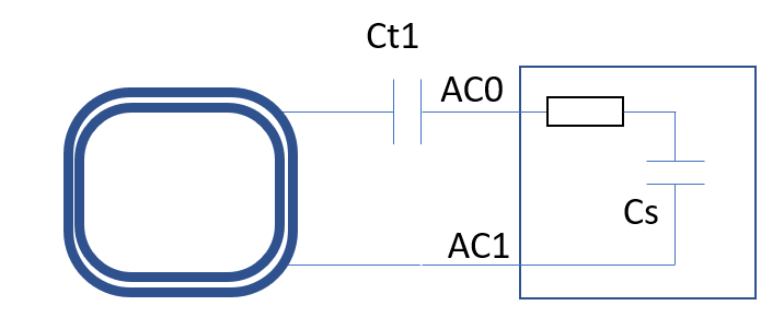

0693W00000WJWfHQAX.pngThe CT1 capacitor comes in series with the ST25TA02K series tuning capacitance Cs:
0693W00000WJWgPQAX.png The new series equivalent capaciatnce seen by antenna is Ctot= (Cs.Ct1)/(Cs+Ct1). Fr=14MHz with La_eq=3.85µH means CTtot=1/(La_eq.(2.pi.14e6)²)= 34.41 pF. The corresponding CT1 value is CT=110pF. Finally, Ct1a=Ct1b=220pF.

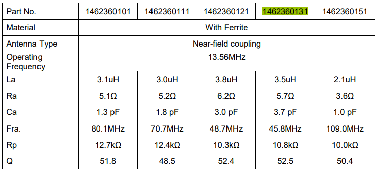

Thanks @Thomas Q.​
Fra is not the resonant frequency.
Attach to this reply, carateristics of this antenna :0693W00000WImOkQAL.png
