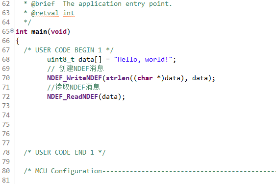

How do I enable the Fast Transfer Mode (FTM) for writing into the Mailbox of the X-NUCLEO-NFC07A1 ?

0693W00000aJ0zfQAC.png我正在使用X-NUCLEO-NFC7A07的软件“x-cube-nfc1�?。�?幸的是,我无法�?�用FTM模�?。我有点困惑,因为NDEF无法接收信�?�,但是我找�?到项目中的具体代�?。
Translation to english:
I am using the software "x-cube-nfc1" of X-NUCLEO-NFC7A07. Unfortunately, I cannot enable FTM mode. I'm a bit confused because NDEF can't receive the information, but I can't find the specific code in the project.
Brian TIDAL
X-CUBE-NFC1 is designed to work with X-NUCLEO-NFC01A1 expansion board.
For X-NUCLEO-NFC07A1 board, make sure to use X-CUBE-NFC7 package.
Rgds
BT
P.-S.: this community uses English language.
