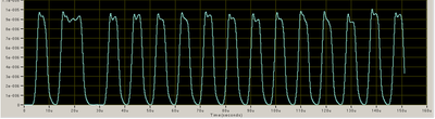

Hi All,
I am trying to demodulate the signal of ISO14443A&B using ST25R3911B. In the case of Type B, I was able to receive data well by setting the type setting and Bitrate, specifying the preset with a direct command, and then setting the unmask. However, in the case of Type A, I checked while changing several registries, but the FIFO data was empty. By capturing the waveform directly with the analog pin, I was able to confirm that the data was coming out well.
So I think it's a registry setting issue, so please let me know if there is anything I need to check regarding this.
the answer to REQA (and WUPA) are quite special frames as no CRC and no parity is included. With default settings I assume that it will be decoded with error and depending on settings of crc_2_fifo nothing may end up there.
Please look also at IRQ status registers and the interrupt for reception, framing and error.
Normally when using the direct commands for REQA/WUPA the reception should automatically be started with correct setting. Maybe your manual unmask receiver is garbling the settings.
Please have  a look at no_crc_rx. Possibly you could also play with no_rx_par and crc_2_fifo.
BR, Ulysses

You say you are seeing outgoing modulation. On which analog pin? Which command do you send? How are you sending it? Do you observe also a response in the field?
Maybe you can share some scope shots, etc.

Hi Ulsses,
I want to put REQA as an analog source in another device and see the digital data coming out as FIFO from the ST device.
However, this did not work, so I set it to test mode for debug and checked the analog signal at the CSI pin.
That signal is:
Looking more closely, in the case of Type A, I confirmed that the signal below matches the target value of 04 00 after Demodulated + Gaussian filter, before data parsing. So, I was thinking that the reason there was no response from the FIFO in Type A was the register setting, but I don't know how to set it, so I'm asking.
