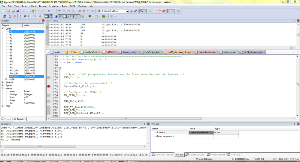

Do I need a separate ST linker to debug the ST25DV Discovery Board? Or is a mini-usb wire enough? (using Keil uVision 5)
RebeccaLo
Currently I'm working with the Mini Usb cable, but debugging doesn't work properly... on YouTube I didn't find a video that helped me. Because although I did everything exactly like in the video, the program doesn't jump to the beginning of the program at the beginning of debugging. Maybe someone can help me?0690X000006DgHsQAK.png
In the videos the yellow arrow was always in the Command Window and not in the Disassembly Window...
Furthermore I don't know how to check my variables I've changed... I add the variables to the Watch but I don't get anything reported.

I found the problem. I had to run the .exe "dpinst_amd64.exe" under the following path C:\Keil_v5\ARM\STLink\USBDriver.

It has an onboard STLink debugger. If you can download and start a debug session, it seems to work fine.

For debug session settings, one can usually instruct the debugger to stop at the reset vector, or run to main. Not sure where this setting is located in Keil uVision.

Stop the application on a breakpoint, and you see the values.
