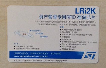

Demo CR95HF-A ISO 15963 max range
pieretti
Posted on January 23, 2014 at 11:23
I'm trying to achieve the maximum reading range from my demoboard CR95HF-A with a ISO 15693 tag (LRi2K). Until now I've obtained best results with modulation-index 10% and gain 34dB by writing 0x50 to ARC_B register: only 5 cm.
Can I improve this result? How Can I increse the antenna current?
Thanks in advance.

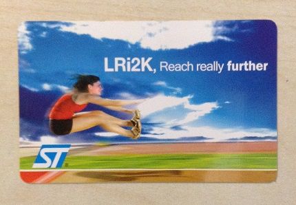

Hello Andrea,
Just to be sure, might you send a picture of the tag please?
thanks
Anais GALLIGANI
Senior II
Posted on January 28, 2014 at 11:39
Also if it is a ISO Tag embedded in the card,
Read range should be more like 8 cm.
Have you ordered a new evaluation kit?
pieretti
Posted on January 28, 2014 at 15:58
these are the picture you requested.
For this card, which are the best CR95HF settings to achieve the longest working range?
Which are the differences between my CR95HF demoboard and M24LR transceiverboard?
Thanks for your support
Anais GALLIGANI
Senior II
Posted on January 29, 2014 at 11:45
Ciao Andrea,
Yes, with the tag you got, read range is more around 8 cm.
Difference betweend M24LR RF tranceiver board and DEMO-CR95HF-A ,
- EMI filter is present on the RF tranceiver board , http://www.st.com/st-web-ui/static/active/en/resource/technical/document/application_note/DM00089926.pdf
- better matching impedance, about that , there is an application note, http://www.st.com/st-web-ui/static/active/en/resource/technical/document/application_note/DM00027198.pdf
I hope you get better result with the board, let us know :)
Have a nice day,
ST NFC/RFID dynamic support
