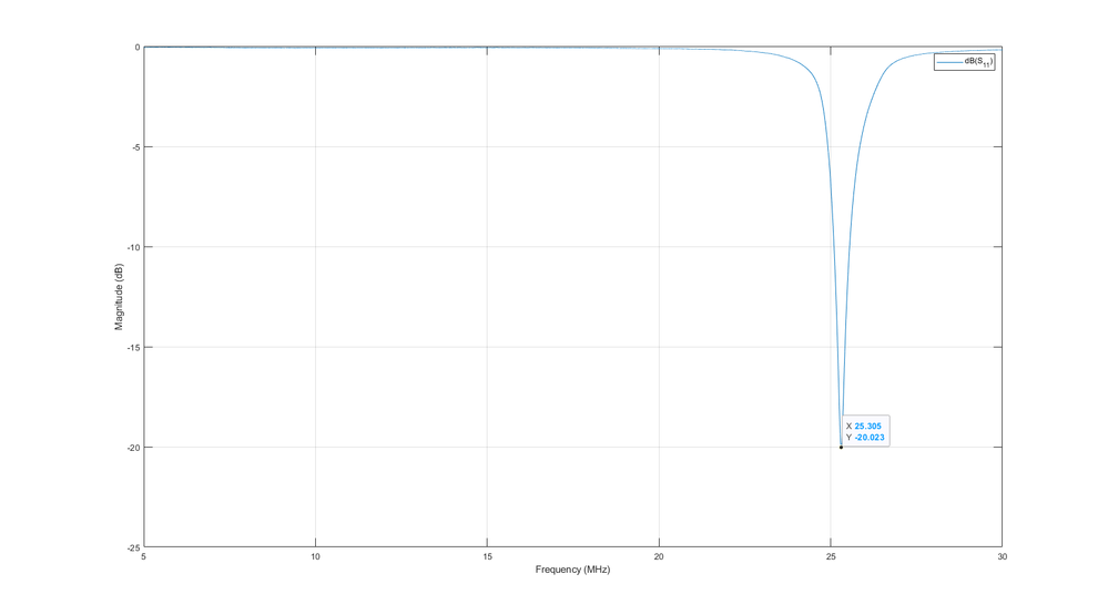

A question about the application note AN2972 (chapter 4.1): How do I build and connect excactly the self-made single turn loop?
I want to do the Antenna tuning measurements with a network analyzer as described in chapter 4.1 (see application note in the appendix). I will use an ZVL-6 Rohde und Schwarz and a coaxial cable. I plug this cable to port 1 in order to do a S11-Measurement as descirbed in the AN2972. But I'm not sure what to do with the other end of the cable.

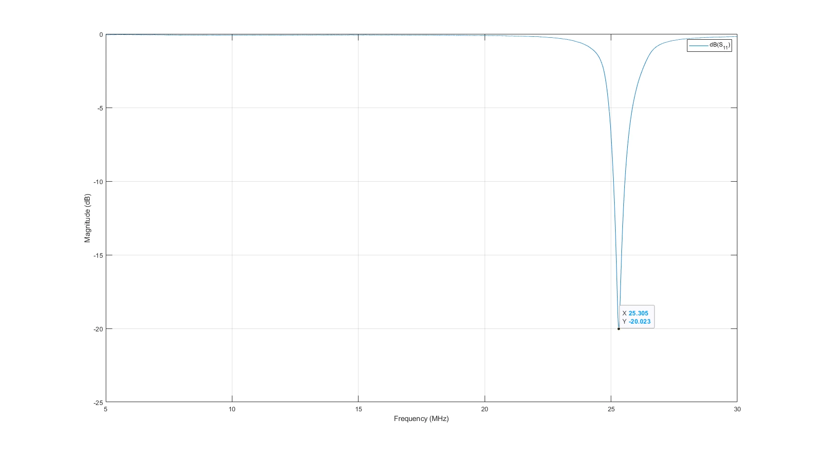

thank you for your good answer. Just in order to make it really clear. With "the real part of probe coil impedance" you talked about the coil of my device, not of the selfmade single turn loop probe, right? So the measurement of the real part of probe coil impedance is already this measurement, which is described in AN2972 (chapter 4.1). And with my results below, I can easely determ the quality factor for this specific received power (and reading distance). Am I right or is there anything else to do?
I did this measurement without any external capacitor in my oscillating circuit. The results were as expected (see the picture in the end):
- the resonant frequency is higher than 13,56 Mhz due to parasitic impedances of the board
- in order to reach the optimium natural frequency, I have to add capacitors with 84,4 pF
Kind regards
