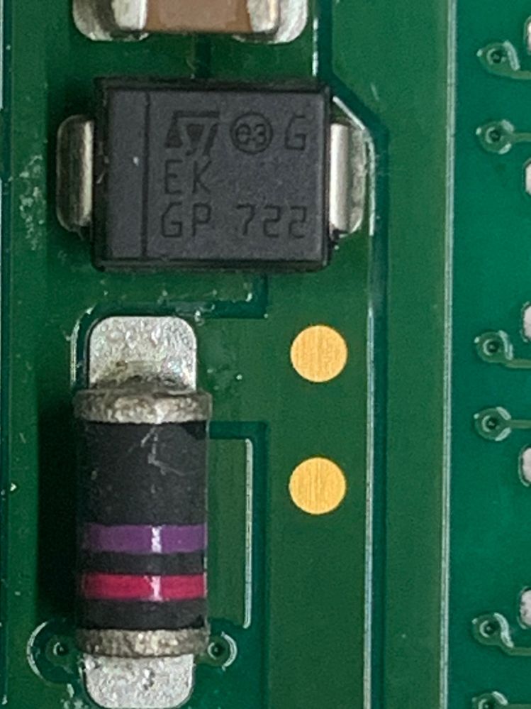

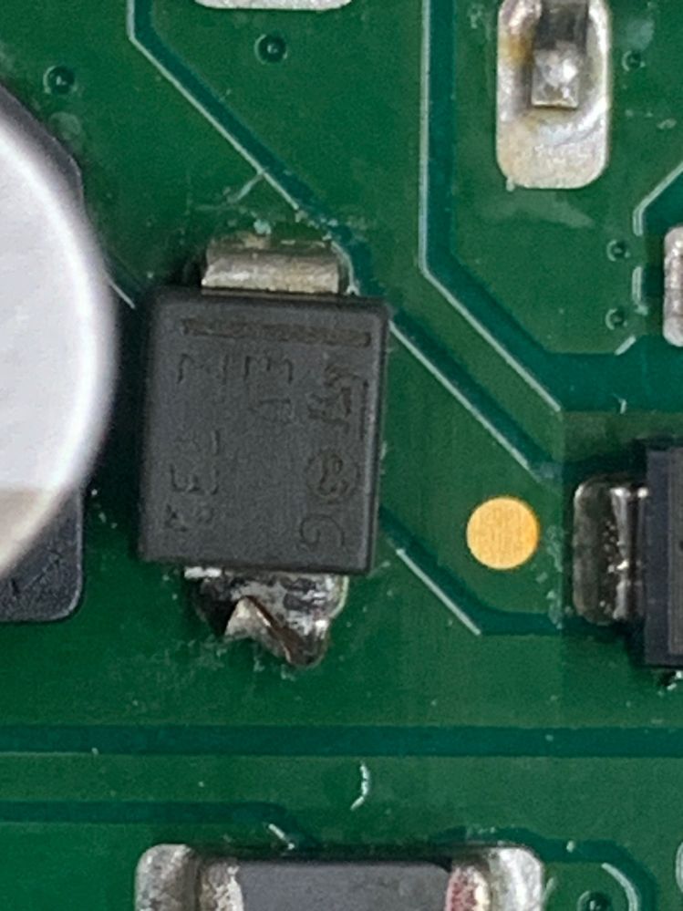

What is ST e3 G ? Hello all, I need some help to know what is the reference of this component ? I can read ST e3 G EK and EV but it's impossible to find something like that on the net to purchase it. Thank You again!! Best Regards

e3 e4 relate to the plastic, lead frames, etc.
ST DIODE EV SM6T36A
ST DIODE EK SM6T22A
https://datasheet.octopart.com/SM6T15CA-STMicroelectronics-datasheet-8321715.pdf
