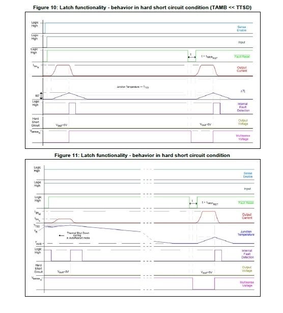

VN7016AJ and VN5E016 have a difference in Short circuit current during thermal cycling.
Kenneth Seo
Posted on April 27, 2017 at 04:05
I am wondering why VN7016AJ and VN5E016 have a difference in Short circuit current during thermal cycling.
1)
    VN7016AJ : 32A   Datasheet 11Page
    VN5E016   : 18A   Datasheet 10Page
2) Recommended for IPS Short: Is it auto-restart or Latch-off?
      VN7016AJ :  Configurable latch-off on overtemperature or power limitation with dedicated fault reset pin
      VN5E016  : Overtemperature shutdown with auto restart (thermal shutdown)
3) How do I know if feedback is turned off with Latch? (
VN7016AJ
