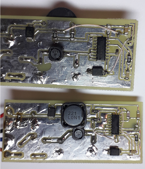

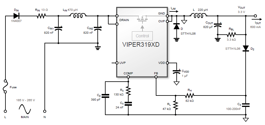

I also used eDesignSuite to build two 3.3 and 15 volt power supplies. This is what the program generated for me:
0693W00000BbQmxQAF.png0693W00000BbQn2QAF.pngI made two boards according to these diagrams:
0693W00000BbQnCQAV.png0693W00000BbQnMQAV.pngIn the process of testing them, I found that in the absence of a load, the voltage at the output of the circuits is 3.8 and 16 volts. Then I set a current of 100 mA from the electronic load and the voltage dropped to almost zero. Maybe the board went to the defense?

Your layout needs some improvement: please keep in mind that this is a inductive switching regulator, the layout of which must be carefully planned. E.g. route the feedback trace as far away as possible from power inductors and other noisy power traces, and keep it as short and with low-inductance and with low-resistance as possible.
You can take e.g. a look at the layout of the very similar STEVAL-VP319X1B, especially the application note AN5521. There you will also find the layout as GERBER ZIP file, which you are welcome to adopt and adapt whatever you like.
If you don't have a GERBER viewer, you can use the tool GerbView, for example, which is part of the KiCad program package and is also able to open GERBER ZIP files directly.

Is the electronic load galvanically isolated from the mains?
Please also try some resistive load, e.g.
  • for 3.3V: 33 ohms (>0.5W)
  • for 15V: 150 ohms, (>2W)

for 15 volts: when setting 100 mA to the load, the voltage drops to 12 V. On the resistive one the same thing.

VOsin.1
For tuning, I put variables instead of constant resistors and selected other coils. As a result, I tuned it to 5 Volts, 0.6 Amperes. It turns out that the program does not quite correctly calculate the denominations of the elements.
