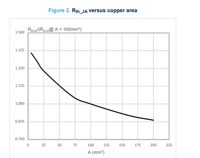

 This  below  graph mentioned in  data sheet of Viper31  IC, i need to know  this mean  , when  i increase  Copper to be area lager than  100mm^2 , this  will  reduce  the thermal resistance , and  also this reduce Junction temperture of Ic  ,then power dissiption will decrease ??
If  true   ??  i will consider it in next design  ,
 and  i need  to know , is  this will  help to  reduce the heat significantly?
The simulation assumes optimal conditions, meaning practically unrealistic cooling. A copper surface of 100mm² is still far from that, resulting in a significantly higher temperature difference. I estimate that for the simulated values, you must assume an unrealistic cooling copper area of at least 2000...3000mm², that is, 20 to 30 times larger, and additionally ensure sufficient air convection. Further increasing the copper area then has no significant effect. Additionally, the ambient temperature plays an important role, because the simulated chip temperature difference is not only added to it but also increases with the ambient temperature. As you can see, many influencing factors must be considered.
This effort is only necessary because you want to implement a buck regulator for the 12V, 500mA at all costs. A flyback regulator is not only significantly simpler but also cheaper to implement and does not require such an oversized switching regulator.
