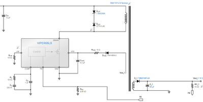

I have designed the same schematics of the website :
The output should be 18V and no significative current (1-5mA output because MCU off).

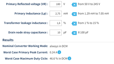

The transformer is a wurth : 7508111324
The transformer parameter is :
The VCOM is always 3.3V during the start-up and it doesn't "move".

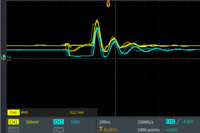

The yellow is ILIM pin and blue is DRAIN :
do you have any idea ?

Apart from possible layout errors, which cannot yet be recognised due to the lack of pictures of the layout, the transformer may be somewhat oversized for the output power of only 18...90mW and may have too high a primary inductance, for example. You can try increasing the output load from 90mW to e.g. 0.5-1W using a load resistor, which gives the transformer the opportunity to discharge the primary inductance.
However, it may also be due to the dimensioning of the compensation network, which leads to an unfavourable phase margin. For the low output power, Cp with 1nF appears too large (please test with 470-820pF), Rc with 18k also too large (please test with 11k).

  • Changed Cp to 680pF and Rc to 18k => no improvement
I will try to change the transformer with one that has a lower inductance. However, I don't see any recommendations on the datasheet.
