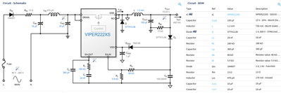

Hello everybody,
I need to user Viper115HS or Viper222XS vith 15V 600mA output at non isolated buck topology. I was designed my Fb pin with 130K Ohm and 11K Ohm resistors. But I can not find right Comp pin configuration. could you write capasitor and resistor configuraton for 15V 600mA output
‎2024-06-14 12:11 AM - edited ‎2024-06-14 12:12 AM
always same questions...?
1. you could use, what eDesign suite telling : (for 400mA max.)
2. 600mA not possible with non-iso buck ; 590mA would be absolute maximum. But "critical" design.
3. Use a transformer (as almost everybody...) and it will work . (If you have the matching transformer ! )
‎2024-06-14 12:39 AM
I can not calculate for 590mA at e-design. could you share
‎2024-06-14 2:51 AM
Me too.. just maximum possible message there. Not yet calculation.
