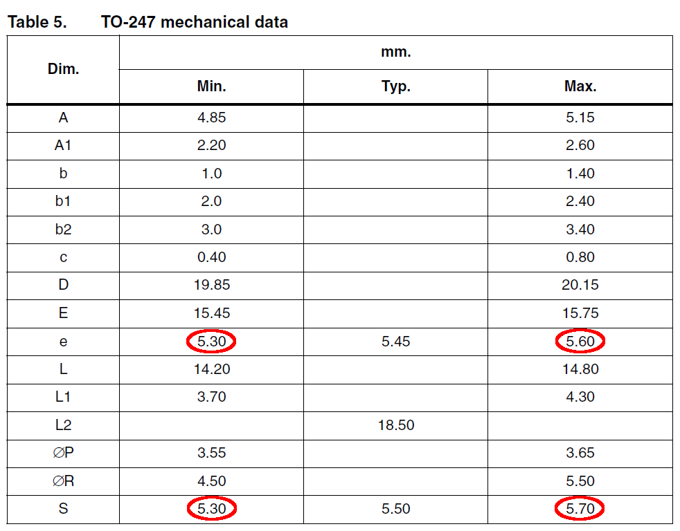

2022-09-01 2:11 AM
From Rev 7 to Rev 8 only tolerance values for dimensions e and S were added:The supplier is always responsible for the delivered goods; the respective manufacturer will only take action after intervention by this supplier.
I am very sorry and I understand your concerns, but STMicroelectronics will only inspect goods that have been purchased from authorised sources and for which an appropriate quality control has been requested there.

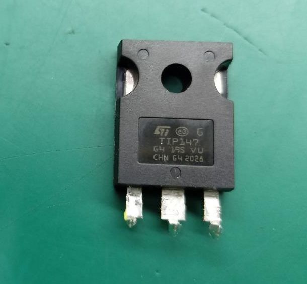

Hi Peter,

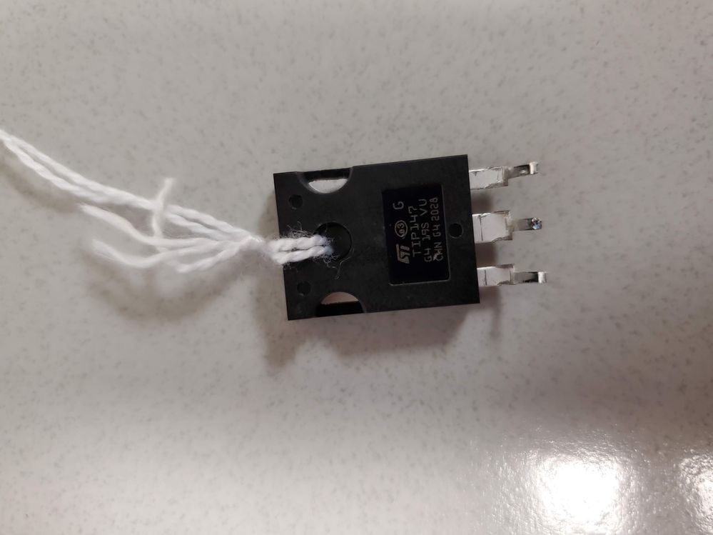

Thanks for your answer, actually we received the Quality complaint on this item from customer, they feedback it can't work normal when input 30V current, it drops to 23V, i share the component picture & video for your reference, what's the problems for it cause, customer is request the failure anylasis....
2022-08-23 2:18 AM

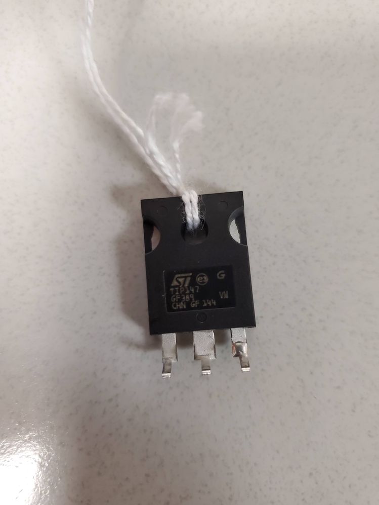

i take the stock item with normal for your reference. both of them are same application..
just replace the components TIP147 with good and bad performance...what do you think ?
do you have any comments i can feedback to customer first? thanks.
2022-08-25 7:25 AM
Well, it seems to me that this has nothing to do with the TIP147, but with your circuit of the board or, for example, the dimensioning or the condition of the coil visible in the video. Anyway, the voltage of the power supply collapses because the set maximum current of 3.1A is reached.

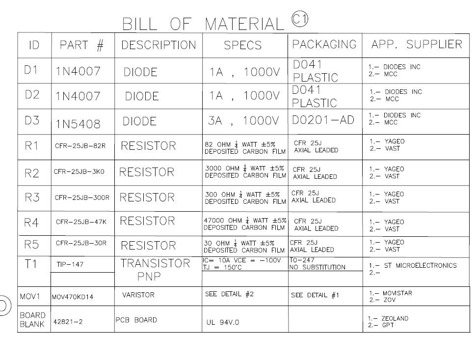

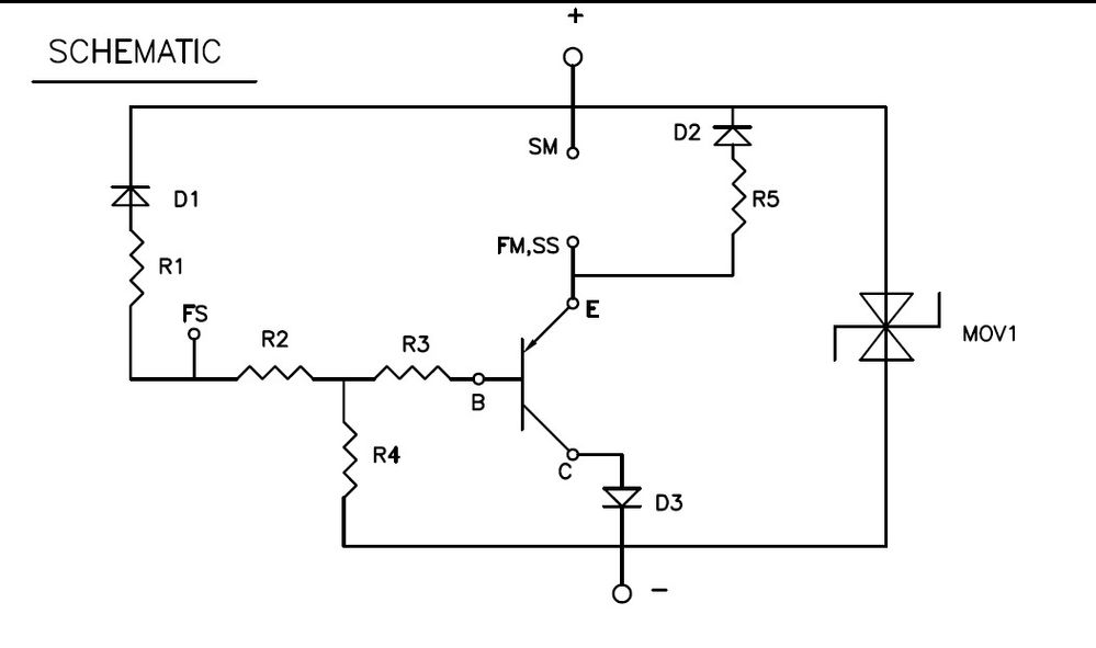

Thanks Peter, i got some information from customer, below are the BOM & SCHEMATIC, is that any help on the case?
2022-08-29 2:12 AM
During the test, only the supply voltage is applied, which then collapses during a video. Since there is obviously no connection at point FS, it is only a question of the current gain of the respective transistor whether the current reaches the critical value of 3.1A here.
For further assessment, we need to know both the expected operation of this module and the parameters of the things connected to FS, FM/SS and SM.
Regards
/Peter
2022-08-31 8:17 PM
HI Peter,
something need your help....
customer make the X-Ray test on the component, lot 2028 and lot 144,
seems this is difference on the pad leg, please see below images,
...Was there an ECN for this change by ST?
and customer have make the test TIP147 by attached doc. for the reference,
It’s critical that we test these for the voltage capacity, can ST advise the method to test. Or can we send the 50 pcs to ST?
2022-09-01 12:25 AM
The transistor TIP147 withstands a voltage VCBO, VCEO of up to 100V under certain test conditions. The respective behaviour, however, depends primarily on the surrounding circuit, especially with inductive load, spikes or unsuitable circuitry can lead to the destruction of the transistor. STMicroelectronics guarantees the values specified in the data sheet, but the respective user is responsible for compliance with the operating parameters.
As far as the lead frame is concerned, I do not have a PCN that has changed anything in the last few years.
The component with the number 2028 looks very suspicious and you should have the supplier check whether it is original and not a counterfeit. A quality inspection of components must always be initiated by the respective supplier, who knows the official procedure for this.
