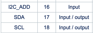

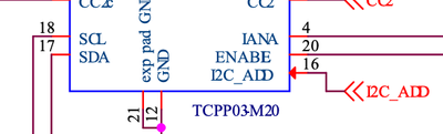

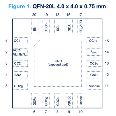

In Figure 1, the pin 16 and pin 17 are swapped:
