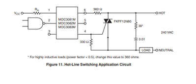

I have a legacy project that I converted to an SMT design but the existing TRIAC is not meeting all specifications of the product. I am evaluating other options and one option that I'm looking at is the T810-600B-TR. In this application, the transistor is fully turned ON and passes 120VAC for up to 12ish minutes, then turns OFF. I have played around and can't get this part to fully turn on under load. The gate is drawing 14mA, gate voltage is 0.9V but the output is only 62VAC under a 500W load.  However, when there is no load, the output is 117VAC.
Why wouldn't I be able to get this part to pass all of the input when it is under load?

show circuit . and where your test points are, for trace 1 + 2 .
somewhere is a cap at the gate/trigger drive , that shifts dc level for trigger.
Here is the schematic with the locations of the Oscope probes.
There is no cap to shift the DC level for trigger but there is a revision coming up that I could add one if necessary.
Thank you for your help!
Mmmm . this is no good circuit for a triac . there are many couplers, to this job, ie. MOC3083 or similar.
with input current > 5mA (from your timer controlled circuit -> transistor out) this "MOCxxx" generates at zero crossing start pulse for triac  - reliable. and low emission on mains...because zero crossing switching.
change your circuit...
