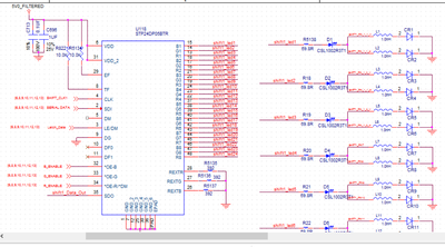

‎2024-08-30 4:03 AM
Hi Peter,
Thanks for the reply. Could you please check the below schematic. Here STP is used for biasing several pin diodes.
‎2024-08-30 5:07 AM
No, the LEDs D1...D8 are connected completely incorrectly and also do not require any series resistors: STP24DP05 does not have high-side drivers without current limitation at its outputs, but current-controlled low-side drivers. So you only have to connect the LEDs with the anodes to the LED voltage and the cathodes without resistors to the RGB outputs of the STP24DP05.
What are the diodes CR1...CR11 for?
‎2024-08-30 5:28 AM
Hi Peter,
CR1-CR11 are pin diodes.
As per our application, We need to drive the LEDs for on and off condition at 1.4V and 50mA current. STP24DP05 output pins voltage is 5V so to drop this to 1.4V we have connected series resistor.
When the microcontroller send bit 1 then LED(D1-D8) and Pin diodes (CR1-CR11) will be on and when when microcontroller send bit 0 then they will be off.
Kindly check.
‎2024-08-30 7:42 AM
No, your idea is still wrong: the STP24DP05 does not have an output voltage of 5V, but internally drives a current to GND. Please take another close look at the data sheet so that you understand: figure 2 already indicates this because it shows an example of a current source that drives the current to GND, figure 17 also shows the connection of the LEDs.
Pin diodes are not necessary in this application.

‎2024-09-09 12:41 AM
Now I understand your confusion: the LED driver outputs are NOT serial, but parallel outputs, which can then also drive up to 80mA to GND. However, the specification VOL in table 7 refers exclusively to serial OUT, i.e. SDO (pin 35), not to R1...8, G1...8 and B1...8.
Please have another look at the AN3981, where the principle of the LED Driver is shown and discussed: all outputs of the LED array drivers work with the same principle, visible in fig 3, 7, 18 and 28.
Please also read sections 4 (Function of the STP24DP05) and 5 (Common Application Information) in the AN3981. You will then realise that you have to change the following points for a successful application:
- remove the unnecessary series resistors R5138, R18, etc), as the current is set with R5135, R5136, R5137, the STP24DP05 acts as current limiter for all LED outputs
- remove the 1nH coils L1... and the pin diodes (you have not yet explained their purpose)
- reverse the polarity of the LEDs (cathode to Rx/Bx/Gx) and finally
- connect the anodes of the LEDs directly to your LED voltage (= VLED+1V to 20V)
Hope that helps?
