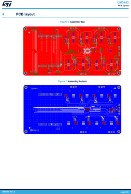

STEVAL-L99MH98 evluation board layout
gdeshmukh
I didn't find the layout this board online.
can someone help me find the layout of this STEVAL-L99MH98 board?
Layout I am asking is not present in the user manual of this board.
Thank you,
Br,
Gopal

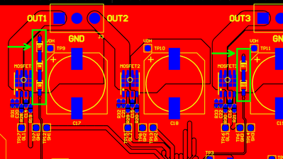

@gdeshmukh
I have marked the placement of D5...11 with green rectangles and arrows:
Hope that helps?
Regards
/Peter

gdeshmukh
Already checked that but no layout file inside it.
You would need to use a Gerber viewer to see the layout from the Gerber files.
Or just look in the User Manual:
gdeshmukh
Thanks for reply. I checked both.
I want to see how diode D5 to D11 are placed but didn't see it in the layout.
br,
Gopal
@gdeshmukh
Hope that helps?
Regards
/Peter
gdeshmukh
@Peter BENSCH @Andrew Neil
Thank you both. I can see the diodes.
br,
Gopal
