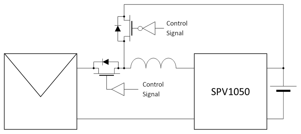

Peter BENSCH
In fact, for such an application, where the voltage of the solar cell is not sufficient to start the SPV1050, a start-up aid would have to be provided. In principle, it could look something like this, whereby you would have to generate control signals 1 and 2 accordingly:
  1. Enable the supply path from the PV panel (and disable the supply path from the battery) when sufficient voltage is available from the PV panel.
  2. Activation of the supply path from the battery (and deactivation of the supply path from the PV panel) if the PV panel does not supply enough voltage.
The SPV1050 provides two signals with open-drain output:
  • /BATT_CONN reports whether the pass transistor between the STORE and BATT pins of the SPV1050 is
    • closed (/BATT_CONN=0=active) or
    • open (/BATT_CONN=1=inactive).
  • /BATT_CHG reports whether the DC-DC of the SPV1050 is
    • working and the battery is being charged (/BATT_CHG = 0 = active) or
    • not switching (/BATT_CHG = 1 = inactive)
0693W00000aJaRAQA0.pngIf you like, you can test whether the two signals /BATT_CONN and /BATT_CHG can be used to switch the schematically shown logic level p-channel MOSFETs using the control signal.
Alternatively, you would have to build a voltage monitor (ultra low power, of course) that:
  • is supplied by the battery without the solar panel being active,
  • applies the battery voltage to the input as soon as the solar panel supplies a little voltage and
  • disconnects the battery voltage again as soon as /BATT_CHG becomes active (i.e. 0)
Hope that helps?
Regards
/Peter
Khoi Ly
Hi Peter,
I was able to use the battery to feedback the start-up voltage to the input and it seems to work properly.
