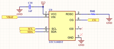

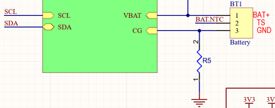

If the maximum current to be measured is 2.5A, you should use a shunt of 80mV/2.5A = 32mohms, maybe only 30mohms to have some margin at the top.
Can you insert some schematics as a picture and please also the part of the programme that reads out the STC3100 so that both can be checked?
Regards
/Peter
Hi Peter,
Thanks for getting back to be quickly!
I noticed that the max voltage is +/- 80mV. Since 2.5A corresponds to 25mV with the 10mOhm shunt, I thought this should be alright?
I will post the code for the working temperature, vs the non-working current. Note unsigned integers are used for now but both values are positive. The environment is C in Zephyr RTOS.

The schematic is as follows:
Thanks for your help.
