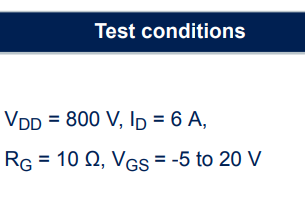

For the SCT10N120 switching tube, I need a switching frequency of 7Mhz, is there any driver chip I can use?

From ds:
So you can use any driver , that can +20/-5 output , for optimum drive.
BUT : your 7 MHz speed --- at about 25ns turn on + 25ns off, 50ns switching at 142ns period (7MHz),
-> no way , forget it.
