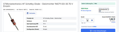

Right, but seems some producing still similar diodes, like this:
Chanzon 1N5711 Schottky-Barriere-Gleichrichterdioden 15 mA 70 V DO-35 (DO-204AH)
or here:
https://www.amazon.de/ALLECIN-1N5711-Gleichrichter-15Milliampere-Kleinsignal/dp/B0CKSFWVXC/ref=asc_df_B0CKSFWVXC
and still some STM diodes in old stock:  1480 STM diodes ...
https://www.conrad.de/de/p/stmicroelectronics-hf-schottky-diode-gleichrichter-1n5711-do-35-70-v-einzeln-155459.html
